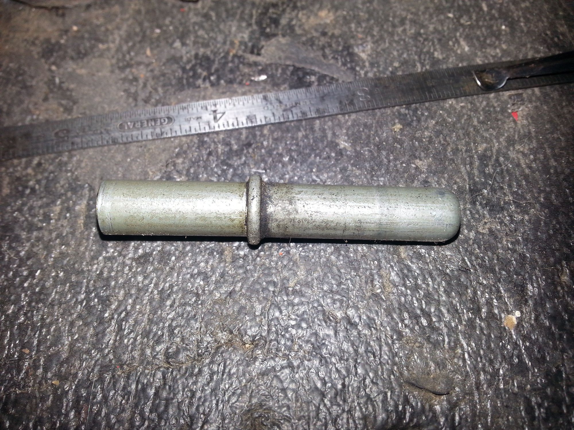

Found this though when I was undoing the vac line to get more room.
That was neat. Wasn't the problem though.
