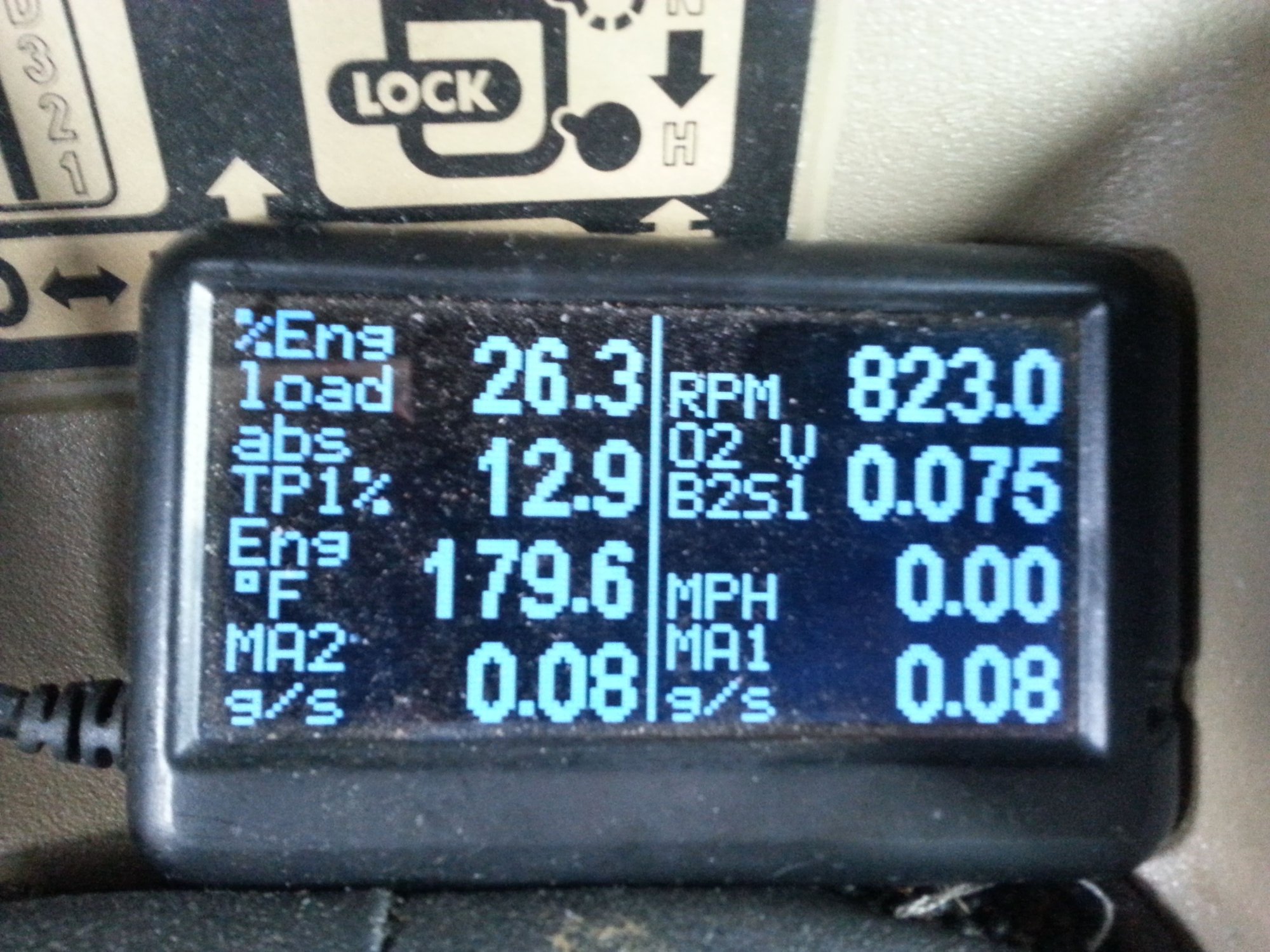

BTW, here are my Ultragauge readings at idle, in gear, foot brake on, and warmed up.

Those numbers look pretty good. Mine at idle are the following:
Rpm: 720s
TP%: 12%
MAF: .09g/s

60 miles and about 5-6 stops. Running just fine.
Here are a couple Ultraguage pics.
At idle in park.
At idle in drive foot brake appled

RPM at spec is 700+/-20 = 680-720 with everything off, no load. Idle is a little low but from experience it's damn good right where its at as long as you're not experiencing any threat of shutdown at stops. It should start to pick up after several drive cycles, usually about 650 would be common. If it does not pick up much then the plenum and trumpets need a thorough cleaning that'll increase the air flow just a fraction.
