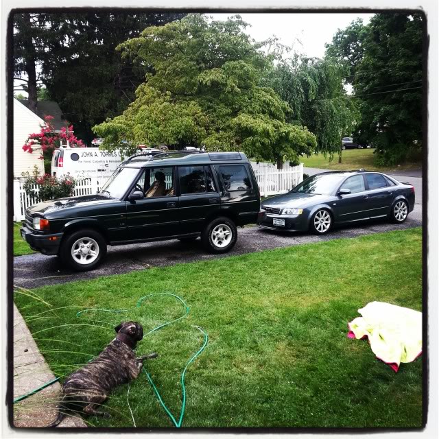

first wash and wax. Samson chilling in the front. cleans up pretty good. the paint and clearcoat are in great shape. drivers side is dent free!

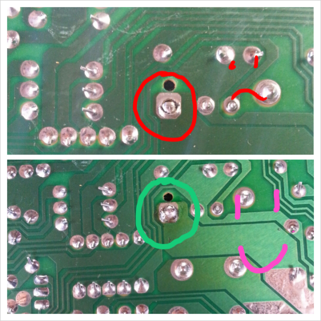

rear window ECU fix. yay O2 to my children's lungs!

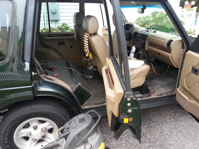

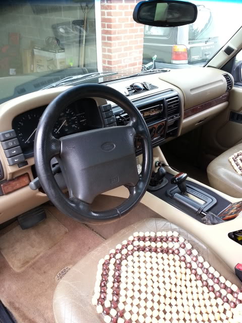

old carpet out, and filthy center console too! a quick not so funny story on why i couldn't get the truck into 1st gear, and "park" was where reverse should be.. the shift gate has a gaping hole in it, much like you may have seen in.. well, never mind, but apparently, upon removal of the center console to try to figure out this problem i found girl's hair beads and like $3 in change packed into the sacred shift gate mechanism. the PO must not have figured this out (or was too lazy to pull out the console) so he adjusted the trans linkage at the transmission to allow park to rest in the reverse slot on the shift gate and so forth down the line. henceforth i had no "1" position. i readjusted the cable, cleaned and relubed the shift gate assembly and off i went.

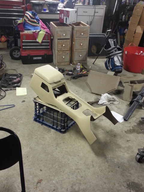

resprayed the center console in sahara beige. it's way lighter than the factory beige dash and door cards, but it matches the A-pillars and my seat beads (hate away! but i love them haha)

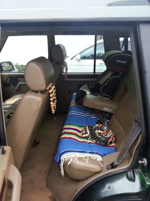

the seats (front and rear) are covered because they are either ripped beyond repair, or stained beyond cleaning. until i can find cheap replacements this will have to do. there are no u-pull it parts on long island. and "junk yards" charge insane prices, so, i scour craigslist in hopes of finding someone locally parting out a disco.. I used a vintage Mexican serape to cover the back seats. alot of hot rod guys used to do this, but i just think it looks cool. matches my style, and i'm happy with that.

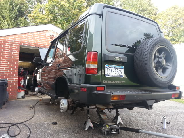

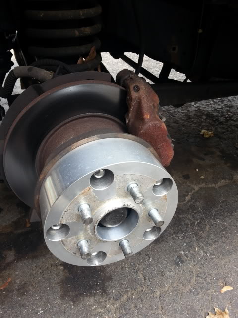

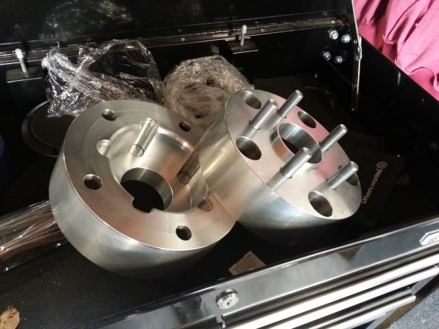

custom 5x6.5 to 5x120 wheel adapters from my friends at motorsport tech (adaptec)
mounted.

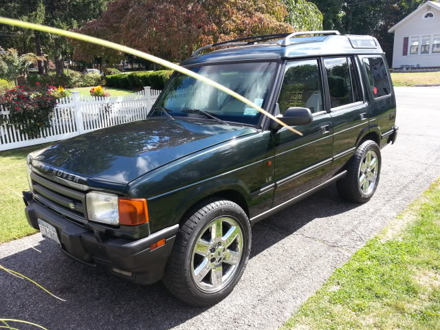

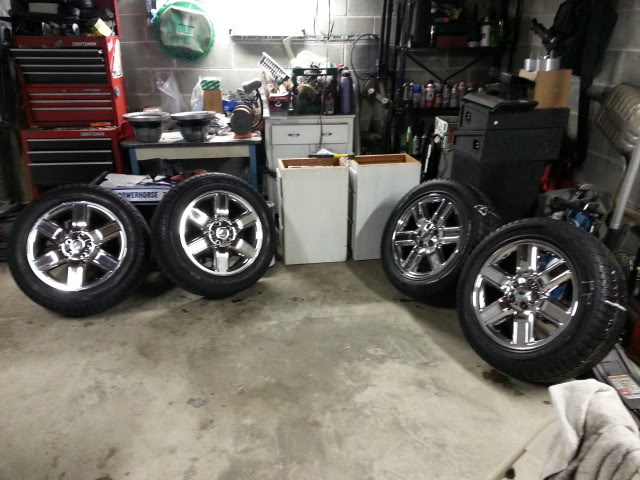

scored some poor condition 19" HSE wheels from a good friend of mine. tires are in EXCELLENT shape. 255/55/19. if you know me (which you don't), you'd know that chrome is NOT my thing, but for fitment and initial shock value i decided to sport them for a bit.

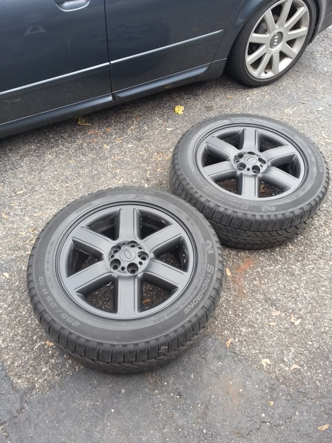

ok so enough of the chrome. plastidip here we come..
i used a spray bottle with 70% rubbing alcohol, and a clean old t shirt and just wiped the chrome clean. super easy. then applied about a total of 3 coats of plastidip to get the desired effect. i'm super conservative with my products (i grew up poor!), so all said and done i used 1.5 cans total for all 4 wheels.

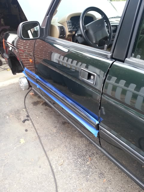

while the wheels were drying (curing), i decided to get rid of my buffed looking, and sun-bleached white door mouldings by spraying it with the almighty SEM trim black; AKA black gold, AKA my favoritist spray product ever.. i simply wiped the mouldings down to with some alcohol to clean it from any wax, or old 'back to black' residue, and taped off all the mouldings.. this really pulls the aesthetic of the car together and gives it a fresher look, IMO.

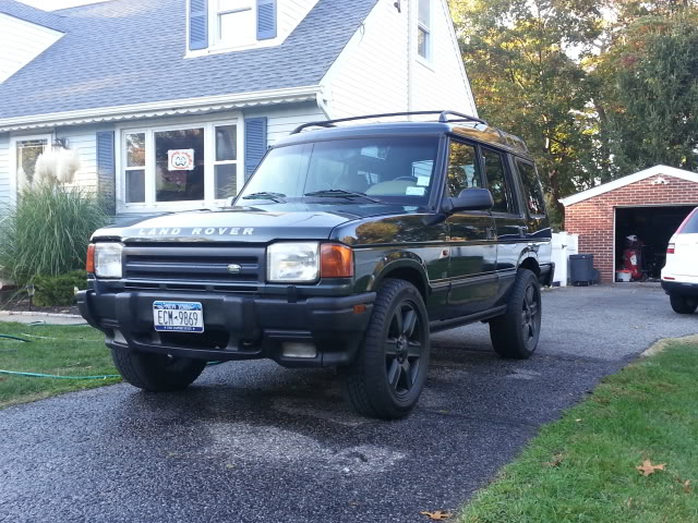

now this is the look i was going for!
has a tough, no-tip kinda stance. the truck handles alot better too! (obviously- with the big *** spacers and 255/55 tires)

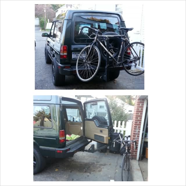

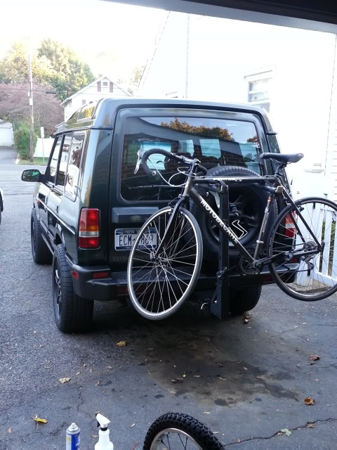

i modified this ol' Allen hitch mounted bike rack to fully fold out. when i got it from my bud, it would only open like 15 degrees. so i cut off the inside bottom corner of the verticle square tubed frame, and welded on a flat square cap to finish it off, so now it will fully extend if needed for access to the cargo area!
