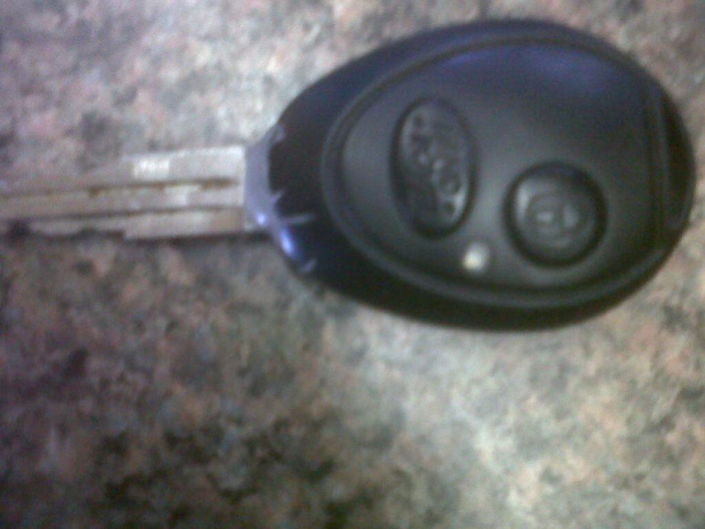

1. The blade of the key seperated from the holder. It's actually a set up that is made to fail. Way too much torque is exertred when the key is turned clockwise. I carefully reinforceed both keys with a dab of JB Weld at the crucial point so as to reinforce them. Be carefull not to get carried away and seal the batteries.JB Weld Again and Half _ _ _ed fixes-img-20120417-00080.jpg

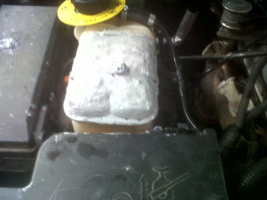

4. People doubt my JB Weld, expansion tank repair, after the unfortunate trouble light misplacement, but I would venture it's now stronger than it was the day it left the factory mold. The trick is to first plug the hole, let it cure, then add succesive concentric layers, waiting for each layer to cure for a while. I have ordered another from Rock Auto for $31.00 US plus $10.00 simply for cosmetic reasons. I tried to pry the patch off the tank with a screw driver as a torture test but it was impossible the grey goop is going to spend enternity with it's white plastic host. JB Weld Again and Half _ _ _ed fixes-img-20120417-00079.jpg

The Land Rover Gods are going to get mad if they aren't already. You got JB weld on the battery cover as well as the fuse box cover.

I had to seal the fuse box, it got burnt too.
