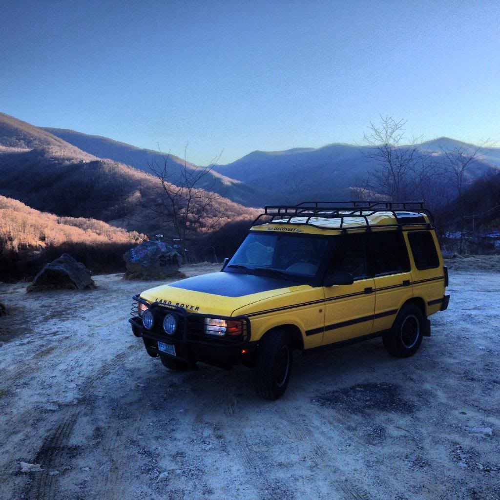

Hey everybody, been lurking for about a month but now I need your guys' help. I recently purchased a '97 Discovery 1 XD edition converted to a 200TDI. Bought it off ebay about a month ago, you guys may have seen it on there. The guy was in Ft. Lauderdale, so I flew down there and drove it back home to NH during my spring break. It was an awesome trip and I bonded with my new girl a ton. I'm in love. She's got some quirks, but the love is real and it is strong. Here's a pic of it in the mountain roads of North Carolina early in the morning. This was my favorite part of the drive. Love me some mountain roads!!

nice looking rig, by the way.
