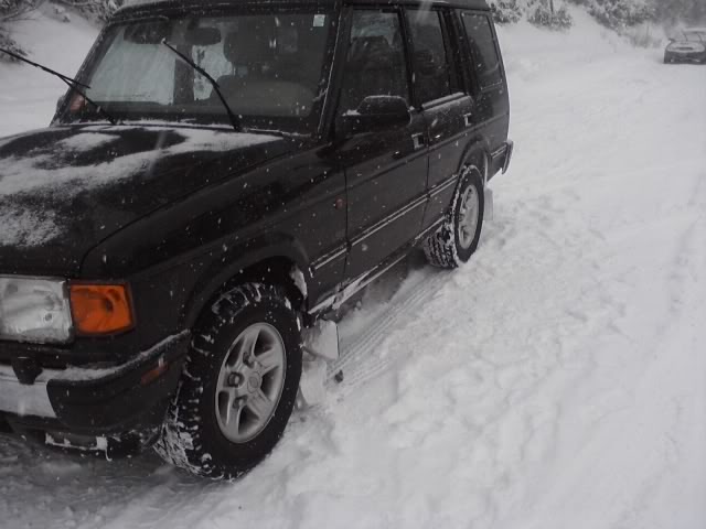

Size:  74.2 KB the road to our house has 2 feet of snow this time of year and about 8 inches of hard pack ice

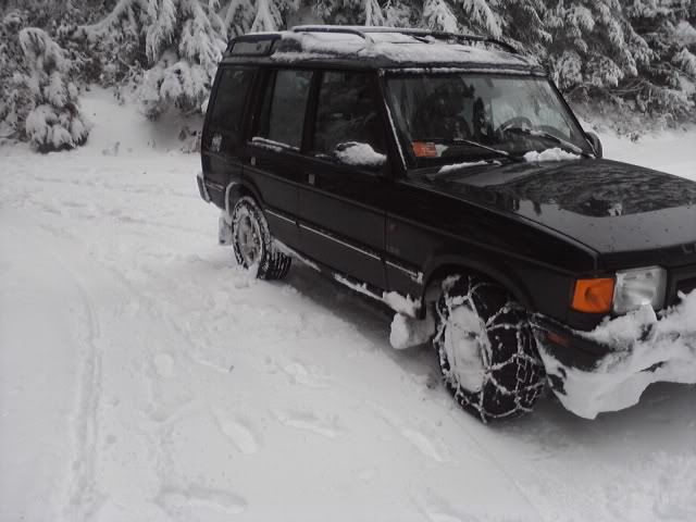

Size:  45.9 KB trail behind our house was extremely deep over 3 feet we neeted chains becuase the from bumper was bogging us down

You can easily strip all the plastic Air Dam stuff off the front and get down to the actual bumper, it's not much so you will most likely want a different one, especially if are gonna put a winch on the front.
