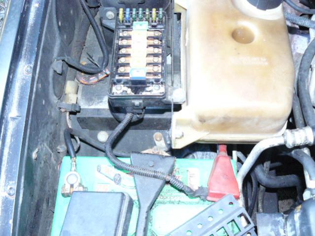

In no particular order -
1. Any access to a friend with a clamp on DC amp meter? MAkes it easier to see how much drain at what point. As an example, my stock D1 draws 85 amps from alternator with everything switched on and at idle.
2. With alternator off line (top bolt disconnected if you like), will truck crank and run on battery alone, and when running what is the voltage across the battery? Battery could have developed problems with all the other issues going on. Age of battery does not matter at this point. If battery won't hold a charge, and keep load up without dropping volts like a stone, then that is one part of problem.
3. When you say you removed fuses while it was running, trying to isolate an excessive load (ground), did you also take out fuse links in the underhood box? Some fuse links and fuses in that box feed other groups of fuses, some feed major load device.
4. Without truck cranked, but key turned all the way to position where oil pressure and other warning lights come on, what does battery volts do? In other words, does the high current drain happen when switched on, or only once it is cranked and engine running? If something strange with starter wiring.... perhaps a way to isolate that in the "not-running test" would be to take off the battery wires on the plus terminal. And separate the short wire that goes from (+) terminal to fuse box. It is small, the large (+) terminal wire goes to the starter (with no fuse). Attach small wire back to batttey, but not big cable that goes to starter.
5. So what I am suggesting is testing system with battery only, and big wire to starter taken off battery (use small wire only that runs to fuse box). You could also meter for ohms on the big (+) cable, disconnected from battery, to frame. Should read open, because solenoid has to pull in to connect starter positive to starter windings. Can also do similar test for fuse box to alternator wire (ohms to ground with wire off the bolt on the alternator).
6. You could be looking at a "rub" (rubbed on a piece of metal and worn insulation) or skint place in the wire groundiing the system out and placing a big load on the alternator. This bad place in the wire could be anywhere from (+) battery to starter, or big bolt on alternator to fuse box. Might be other places but you start running out of large cables that don't have fuses. Unless truck modded by aftermarket add-ons.
7. Who tested alternator? If done by a parts store, try another store. Sometimes behind the counter techs or their equipment can produce different readings. Your symptoms indicate a bad regulator and some open diodes on the alternator. Volts low, and volts drop when moderate extra load switched on.
8. Wire on back of alternator pretty simple - big one goes to fuse box, middle sized one goes to the "volts when ignition switched on and battery warning light on dash" circuit (battery light does come on before truck cranks?). Very small wire with push on lead is the drive signal (pulses) to the tach.
Attached Thumbnails Killed 3 alternators now... Last 1 only lasted a day-p1120271.jpg   Killed 3 alternators now... Last 1 only lasted a day-p1120272.jpg
Old Apr 26, 2012 | 05:31 AM
Posts: 16,322
From: Savannah Georgia
ummm ... any chance the two terminals in the front of the under hood fuse box need to be cleaned and tightened? And for long life issues, any overheating, or is your radiator fan blowing air toward the engine block (radiator cowl directs that air flow into alternator, if rad fan was on backwards, not good).

Old Apr 30, 2012 | 05:36 PM
Posts: 16,322
OK, my D1 has been under the shade tree for over 24 hours. Here's my voltages:
Key off - battery = 12.78 ; alternator output 12.78 ; altenator other wire - 0 volts
key on - battery = 12.41 ; alternator output 12.38 ; alternator other wire 1.05 volts
running at 700 rpm idle - battery 14.13; alternator output 14.21 ; alternator other wire 13.60.
Nothing other than basic stuff running, dome light, no AC, no head lights.
Clamp on amp meter measured 17.9 - 18.2 amps from alternator, 2.3 - 2.5 of that going into battery.
The main cable is brown, and goes on top bolt, then over to underhood fusebox (100 amp fuse link). The smaller cable is brown & yellow, goes on next bolt down. This one should be closely checked with meter. The "flying lead" that plugs in goes to tachometer and can be disconnected for these tests.
Your meter - have you checked it against another vehicle?
What volts does you battery have when nothing on, key off? With key on, but not cranked? Do you see it increase once cranked? Just me, but 12.3 seems way low.
