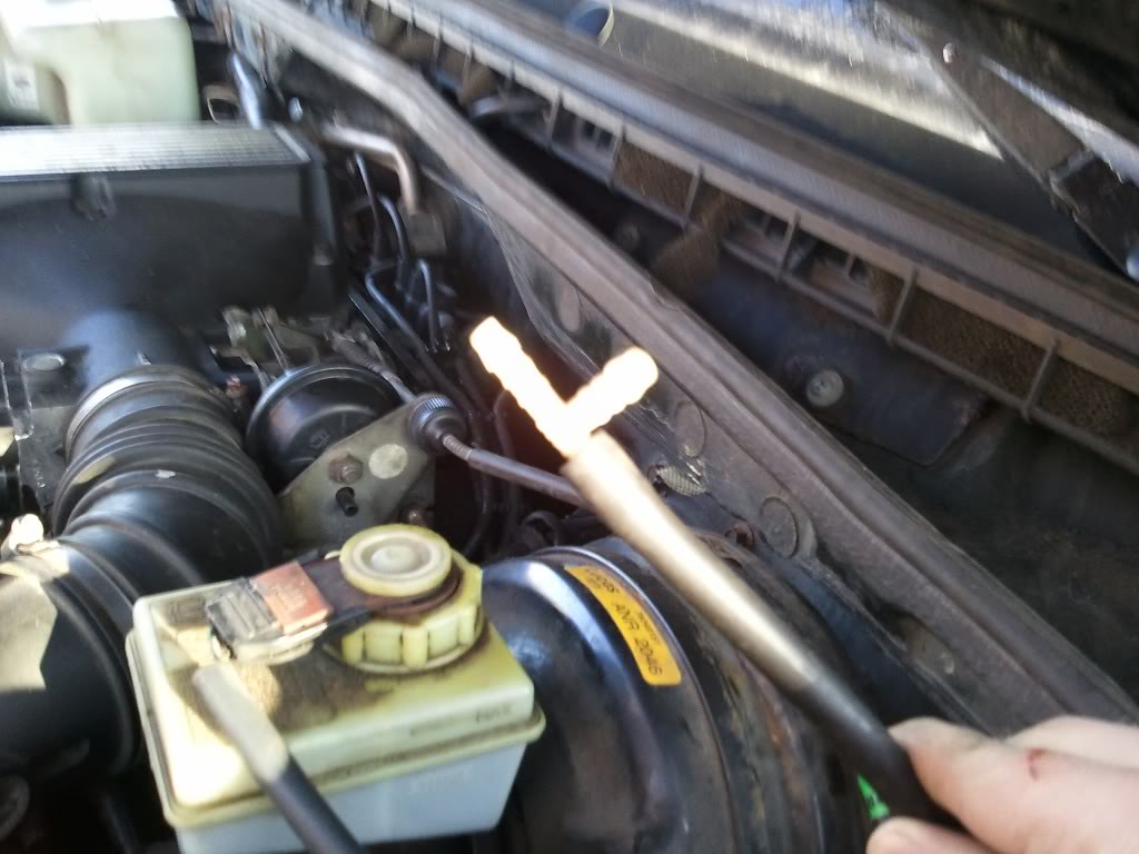

Kind of off topic but I also have a couple of mystery vacuum lines. This was found right where it shows in the picture, near the brake cylinder

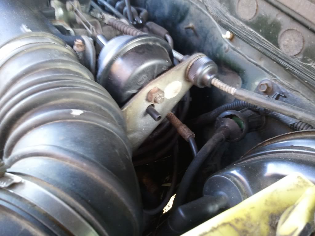

And I am missing my cruise control vacuum line (is it the same vacuum line?)

The axle leak is a bad swivel ball seal, I would get a full seal kit to fix that. The power steering boxes have a problem with leaking on these trucks you can either try to reseal it or get a reman box but I would give everything a good cleaning with some degreaser first. As far as the vacume line with the T fitting that looks to be for the cruise controll

You are missing 2 hoses for your cruise control, one goes into the brake booster and the other goes into the regulator.
