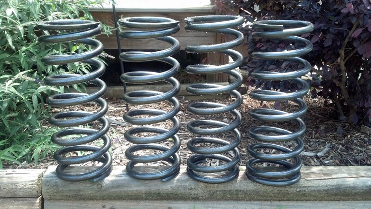

DS D1 TF springs are slightly taller. Thicker coils in back. If you set the rears and fronts side by side you can see the difference.

I put a TF lift on D1. Only after we got them backwards did we realize they were side specific. Upon closer inspection of the springs we noticed the DS and PS markings.

Front and rear are both side specific
