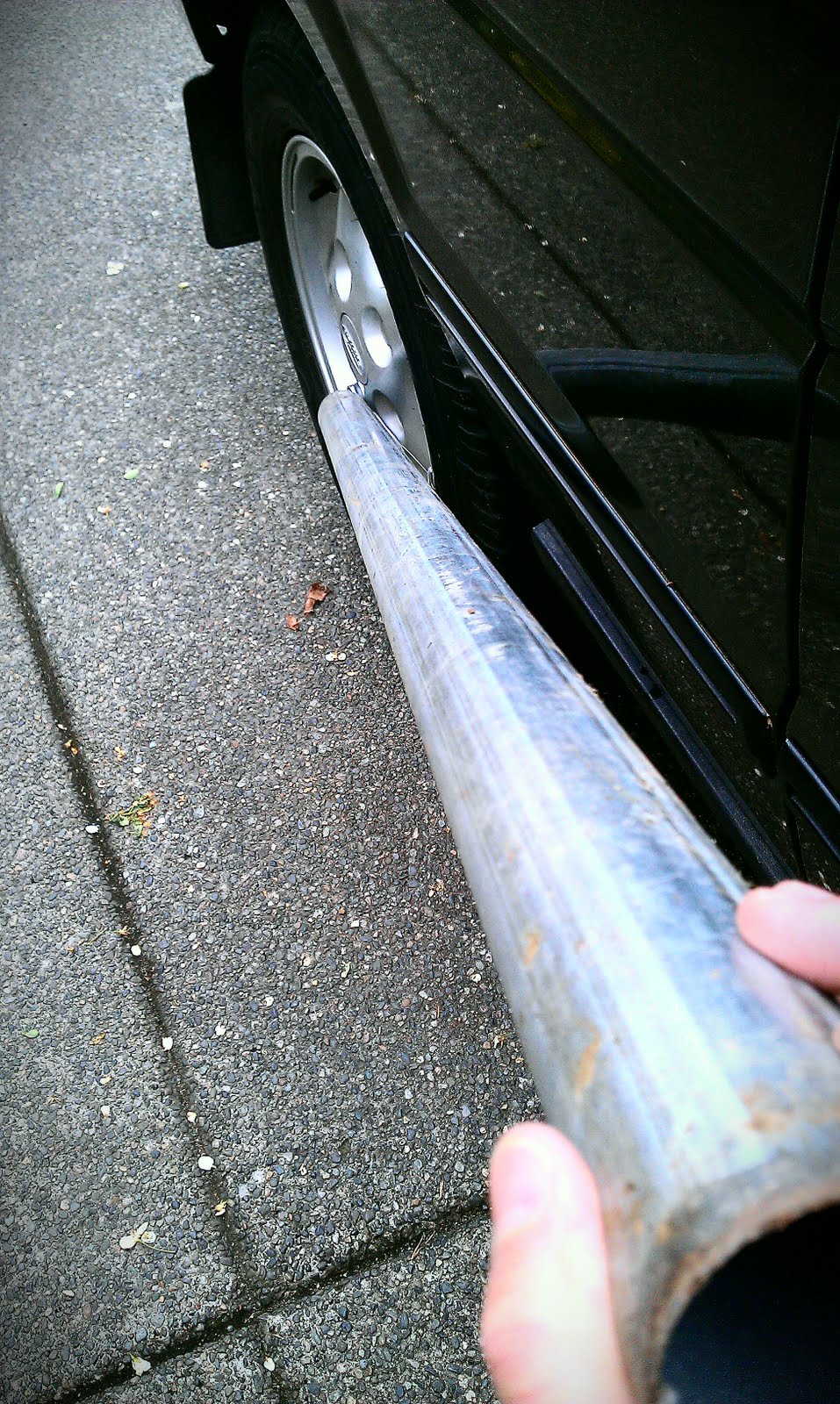

Default Leverage Gets The Lugs Loose
I finally got my lugs loose today. It took some serious leverage; like 4 feet of steel pipe on a breaker bar, but it worked!
