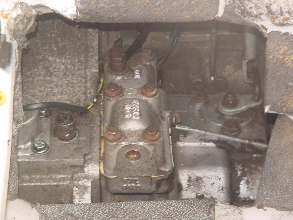

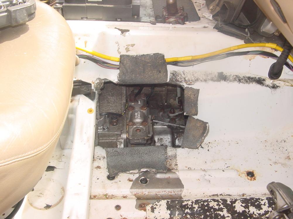

Here's a link to a local LR Forumhere in pittsburgh and the posting I did regarding my CDL shifter linkage fix. It has links to lots of pics, primarily dealing with the CDL linkage.
http://www.fplrg.org/forum/viewtopic...203c3910a40897
Here's a couple of pics of the access panel I "installed" in the passenger's floor board to get to eveything much easier. The CDL shift linkage is to the furtherest right side of the pic, that is the pivot point tat rotates and engages or disengages the CDL.
The round can looking device to the extreme left is the hi/low solenoid.
If it fails, it will cause shift problems.
After I completed my repairs, I pounded the "flaps" back in place,sealed it with RTV and cut a patch panel to cover it all up and pop riveted that in place. A little bit extreme maybe, but I had to be able to see and get my big hand in there to get to the CDL switch to replace it.
