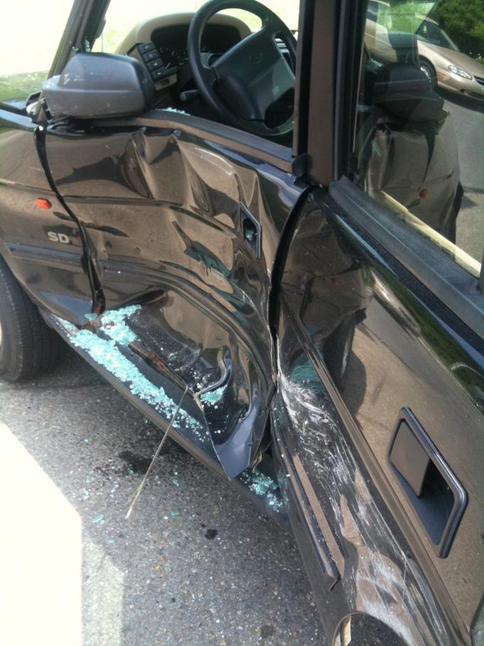

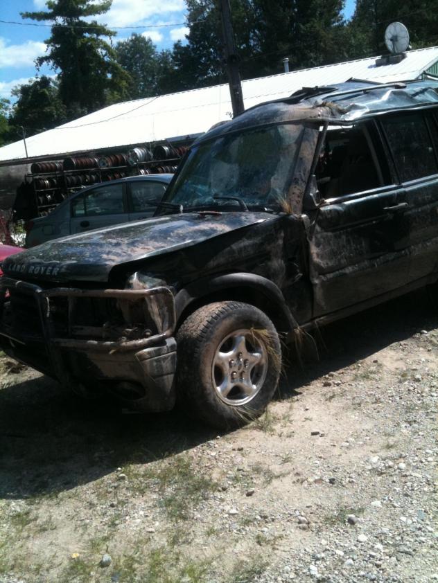

The DI was t-boned by a semi and the guy walked away, the DII was rolled at 65 mph.
So yeah, they are pretty much indestructible.
