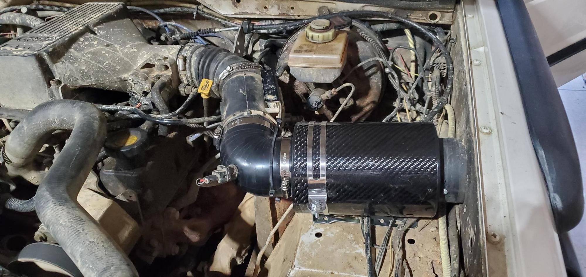

Trailkarma's Avatar
8th Gear
Joined: Aug 2022
Posts: 8
here is a pic of my intake setup using a cheap Amazon filter. I have RTVed every connection for a water tight seal.
