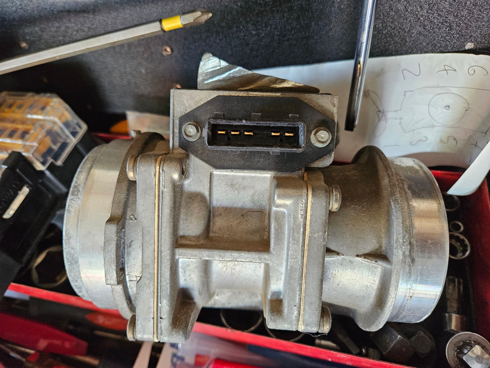

I have one of these.
ERR5198
5AM Airflow Meter
DM if you are interested.
