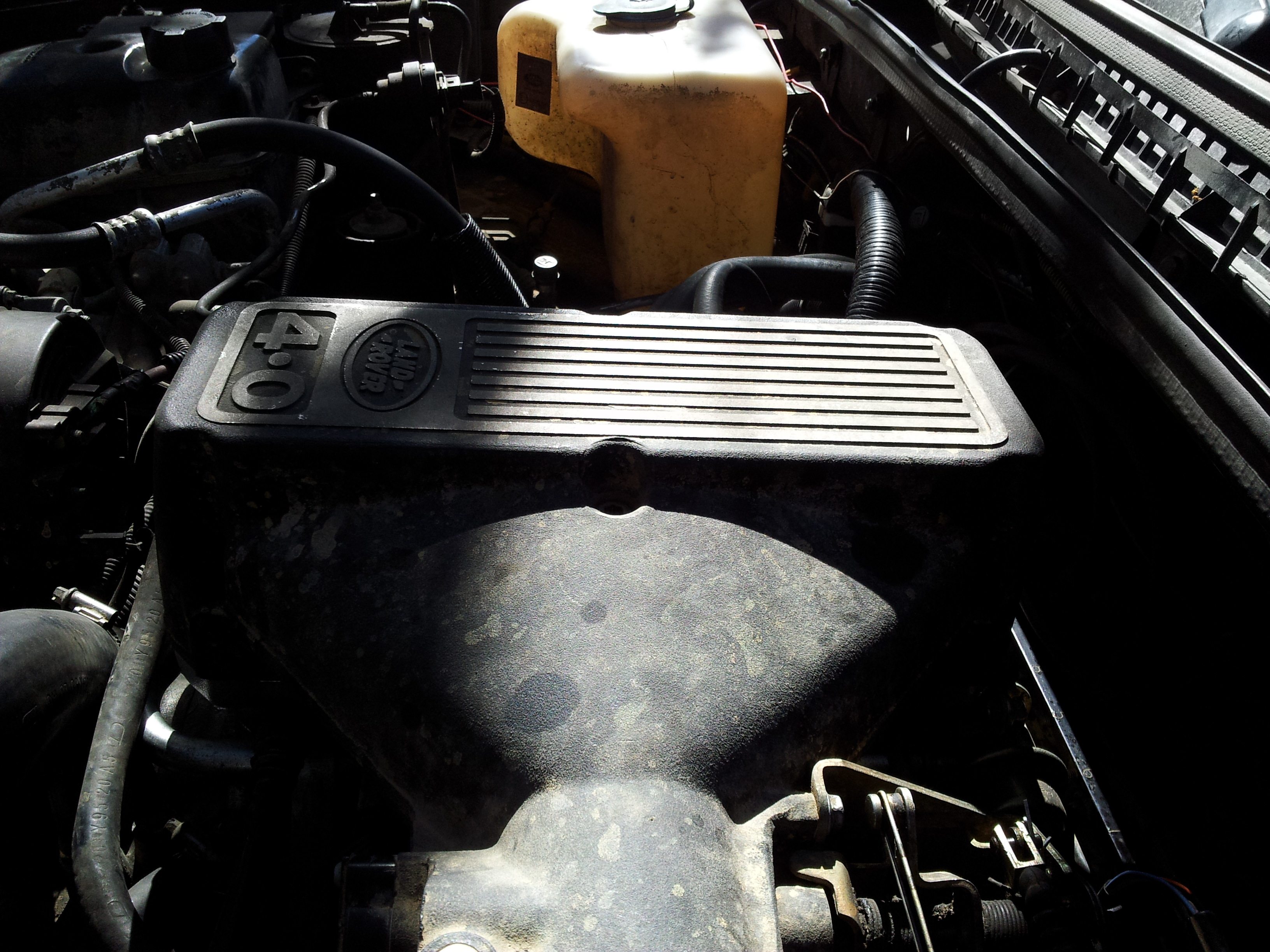

Well today went out and tooled round with it till I started getting super frustrated. Checked the manifold bolts all were good, then I proceded to swap round the coil packs for #6 and it still is on 6 so that's not it, tried the VSS unplug and see if that changes anything and nupe nothing there. Oh the picture is where the thumping is coming from. Not sure if its just cause of the missfire or what. It's the cover for the plenum. Not sure what else to try have checked all the wires and plugs, the coil pack, replaced injectors, checked VSS (via unplug method) all vacuum lines seem to be good, not sure about the PCV valve and even if that would be a issue. Also checked the ECU for rust damage and none there. Am out of ideas, probably will check the O2 sensors even though they are brand new and check for nastyness on them, and replace fuel filter as I was going to anyway. Well back to hours of google search, and with any luck we can come up with something :S

Think for a moment, you swapped out the coils and the #6 problem did not move. That tells me the problem isn't with the hardware but the wiring. Injector plug all the way back to the ECU. You've done everything else to eliminate, wiring is the only thing left.
Two other issues you brought up you need to be positive about because they do effect how the engine runs, spark knock, idling. The PCV has a direct effect on idle speed. Check it, clean it if needed. Double check the fuel pressure regulator because I'm not so sure you've nailed that down. No vacuum leakage through the short hose, fittings nor through the diaphragm.
An issue that came up in another thread in the DII section was an individual was receiving misfire codes for cylinders and the O rings where cracked, dry rotted at the cylinders that popped the MIL. Did you check, replace those as well with the fuel rail, injectors?
