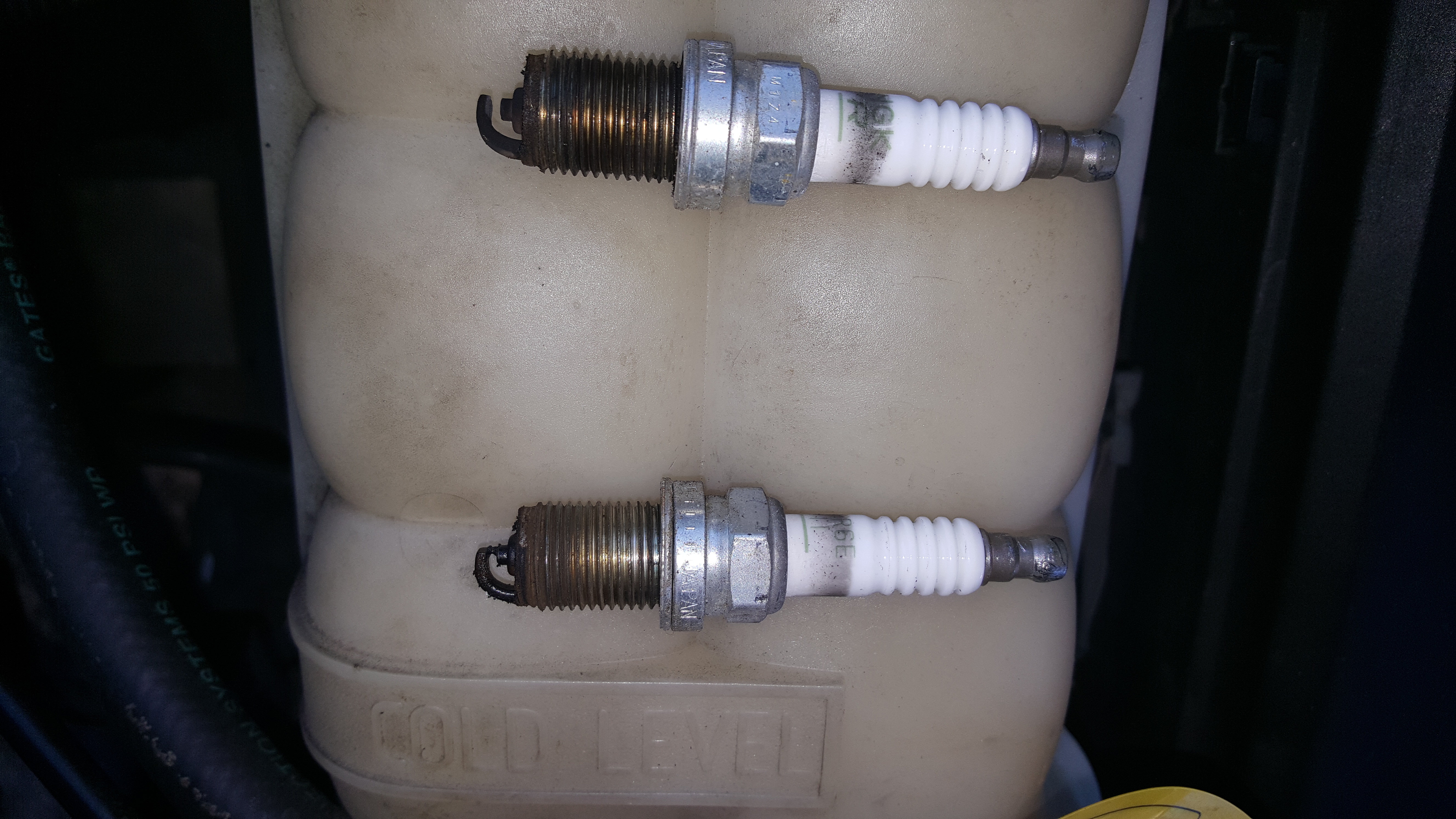

Your post was like a horror story to me lol because I am having the same issue, missfiring on #6!! I was so disappointed when I came to page 6 and your problem is still going on i feel your pain!
I already checked the wires and coils by using the inline spark plug wire tester and they all came out good. I dont have the tool to take the spark plug out tonight but i will do it as a first thing in the morning. Do you have any tips? Lol dont scare me, please! I am few inches away from putting an ad on craigslist!
edit: also the CEL keeps flashing!

I reset the codes(via bluetooth obdII) and crank the engine, it doesnt give any codes or CEL for few minutes( i can drive a block or two) before the CEL flashes for few times then stays solid. It flashes few more times on random times.
edit: i got the spark plugs out from cyl6 and cyl4, they both look horrible but cyl6 has some metal shreds in it(just like the ones that sticks to the oil drain bolt magnet. I swapped them and now i get a p0304 code. I might be able to get away with a set of copper spark plugs!
Left cyl5 right cyl4 in pic
Second edit!: i took the faulty/dirty spark plug and cleaned it/sand papered it a bit and now the truck runs like a champ! My only problem left is the o2 sensor errors which is also fun to diagnose, said no one ever!
Good luck to you on this stressfull path, M3g474rd.

Sorry for the late reply, am glad that it was just plugs in your case and were able to get it up and running . Also thank you for understanding, this has been a trying time. What I would suggest to anyone is after plug check, and wire check would be test compression on the cyl. that it is throwing codes for. If those are good, well have read many things on what can cause it lol.
As far as your o2 sensor you may be able to get away with just pulling em and giving them a good clean rather than trying to track down what one/ones might be bad.
