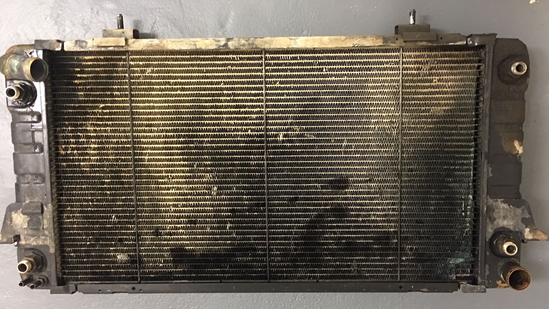

PROBLEM SOLVED: thanks to this forum, and big shout out to JVARNADOE !
Finally got the Nissens installed ($305 at LK8 ).
One hour city driving with AC -- 185 to 190f
160 mile highway at 65-70mph with AC -- 178-185f !!
Refused to believe my eyes, and kept switching between DashCommand and Torque Pro lol.
a good day.
(pic attached of 23-yr old culprit - 40% clogged and ugly)

Keep the original and acid flush it. Keep it as a spare for when your tanks eventually blast off....... lol.

copy that. exactly my thought. bastard's gotta suffer for all the grief it gave me.

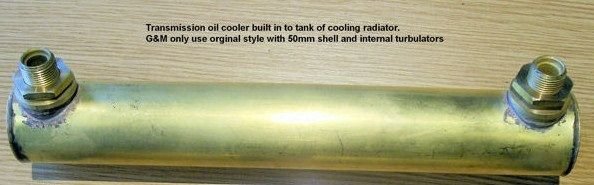

After using these many times I know you will get very good results with the NISSENS Rad.
And looking at the condition of your old rad I would 100% save it and recore whenever you find a shop with decent rates.
The biggest advantage of the OE rad is the tanks and the size and material used in the oil coolers.
Most aftermarket oil coolers are a small stacked plate design.
OE oil coolers look something like this ( worth saving ) >
