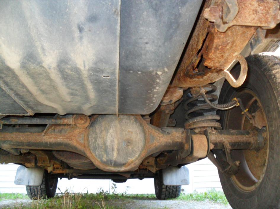

You don't have enough cans. One in oil, one in gas, and third suck in to intake via hose from valve cover. While at it, spray some carb cleaner or such down the oil seperator in the valve cover.
BTW your frame will look like this if you don't take care to wash it off after impressing everyone on the beach. And wifey will knock those wreckless eyeballs outa your head, so watch where you are driving, not the tan lines of the beach creatures.
https://landroverforums.com/forum/at...framerust2-jpg

I saw one thread from someone who takes his old oil and puts it in one of those hand pump sprayers like you use for spraying the lawn. He sprays the entire underside with the oil to coat all the steel and help prevent oxidation.
When I worked in Defense Industry, the spare parts on some contracts were basically oiled really well, wrapped and sealed, with that level of preservation, they could be on the shelf for many many years and never rust. In a heavy salt environment like the beach, that may be worth doing.
I have been using that method of cleaning up old tools and such I have found, works well om steel or iron.
