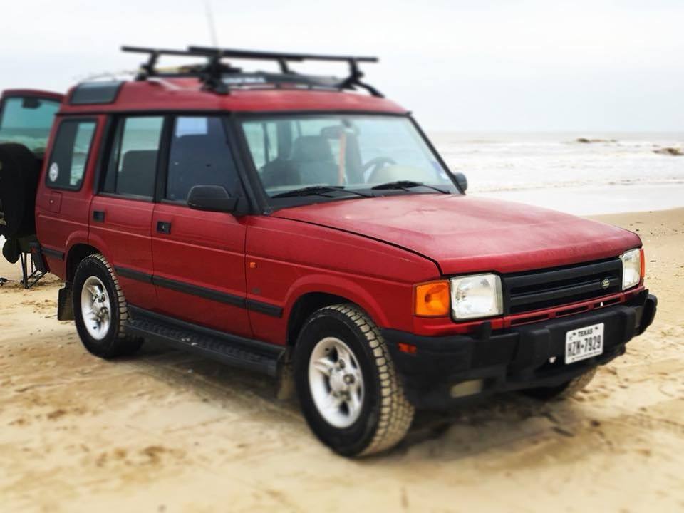

New here, but have owned my 1997 Disco 1 for about 2 years now. Today my alternator crapped out. Any advise on where to purchase a new one, (best deal/original or better quality). Also what alternators will swap out, for example will a alternator from a disco 2 fit a disco 1? Just looking for parts that might be interchangeable, very few if any disco 1's in the junk yard, but a ton of disco 2's and a few range rovers. Love the truck just want to get it back on the road soon.
