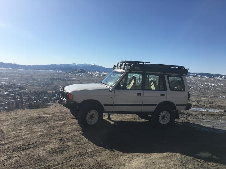

Hey guys, I'm the new owner of a 1996 Discovery - Expedition Build by a guy in the Pacific Northwest with NorthWest Overland.
It has an impressive build, but for the purposes of this question it's got the 4.0 with a slushbox, 20k miles on new heads and gaskets, camshaft, hydraulic lifters, timing chain and gears, water pump, etc so the motor isn't "tired"
I moved it to where I am in Montana at 5500' elevation.
Current tire size is BF Goodrich Radial MT KM2s, 255-85-R16
I am finding when I go up inclines that it really struggles. I can barely push 50 mph in a headwind at a slight incline (again, moving from between 3,000 to over 6,000), without it popping down into 3rd (or 2d!) and even then I've been passed by a semi truck.
On flats (or downhill) it cruises easily at 70+ mph.
I mentioned this to the previous owner and he suggested I switch to a 235/85-16 tire. I know that some people switch gearing, but I figure the costs would be about the same to switch gearing as it would be to get a second set of tires (I'd get a second set of NATO rims, too, so I can just switch them out). My thinking is that if I'm really going overland in it I can put the 255's back on it in an hour or less, but keep the 235's on it most of the time -- IF (big IF and that's why I'm asking) the 235's would see better performance (speed and road climbing) over the 255's.
Will 235/85-16 be any different gearing than a 255/85-16?
Thoughts? I really suck at right sizing tires (and maths) so any help would be appreciated. Not that I don't trust the previous owner but looking for a second opinion on the 235's on this rig.
If it is only going to get me 2 mph faster it's not worth it and I can just deal with the slowness (I know this isn't a speed demon but at times it is just almost embarassing how slow it can be going up a mountain pass).
