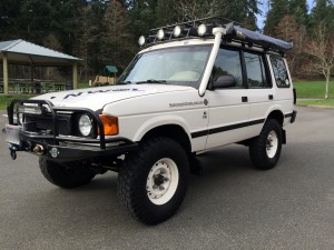

I have 255-85-R16s all around.
Came with them. I think I'll drop to something else later on, I just don't know what. I have a 2" OME lift and with these tires this thing is tall. I also think that the taller tires make it go a lot slower. I saw an SE7 on the interstate the other day and it was making speeds I can only achieve downhill in a tailwind.
