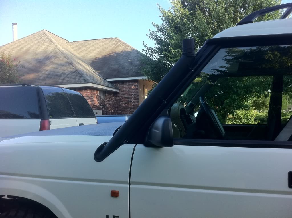

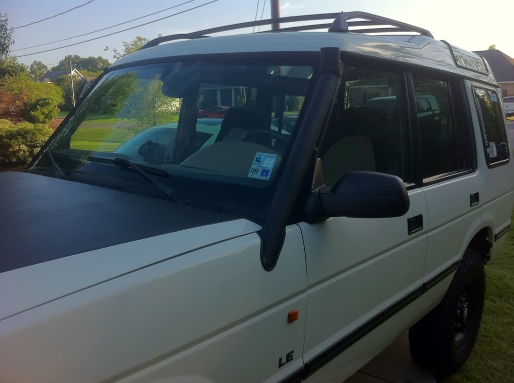

That is indeed pantyhose on the top as a prefilter.. FOR NOW.. thats why it has the funny shape.

Still need the safari head to come in.. I started off with pvc but i decided to just take a drawing to a welding shop. 60$

Nice. How is that attached to the fender?
It goes behind the fender it's held in place by two l brackets on the a pillar and a 2.5" PVC strap behind the fender. Flexed in with 3" flexible intake hose.
I was going to go with 3" I'm glad I didn't it barely fits behind the fender. Because of the angle it follows with the a pillar. If it came straight up and the followed the angle you could prolly 3".
It's a 45* bend and then a 40* bend at the top with a 10* kick to the right.

care to show how everything is attached in the engine bay? Im interested in doing this myself. At advance we have all kinds of intake tubing
if/when I get that panel off agian I will... Know where your factory jack is? I removed it and ran the hose though the perfect 3" hole behind it.
