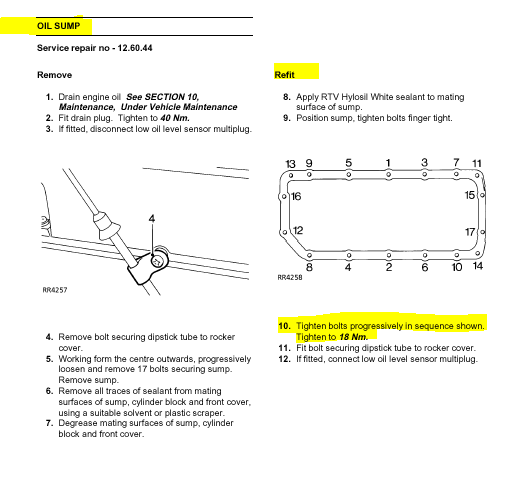

I'm not the biggest fan of RTV because too much and it breaks off in the pan and clogs the screen in the oil pickup. I can't tell you how many LRs I've bought with this problem.
Oil Pan Gasket (# 602087 Cork/rubber) > https://www.lucky8llc.com/collection...et-pr2-payen-2
Or local at any Advance, Autozone, Napa... ( VICTOR REINZ #OS32344 ). If you choose RTV or a gasket just be sure to torque the pan bolts in the sequence in the pic.
