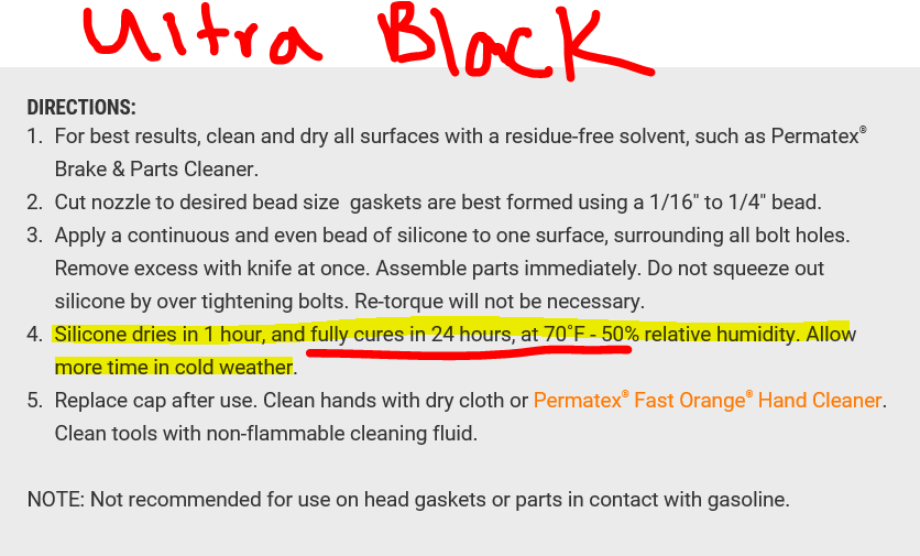

If you are using the Permatex Ultra Black or Gray then full cure takes 24 hrs. I think Right Stuff is the same, but you can get all the info you need here >
https://www.permatex.com/products/gasketing/ultra-series-gasket-makers/permatex-ultra-black-maximum-oil-resistance-rtv-silicone-gasket-maker-4/
Thanks so does that mean that I can't start the car for an hour or I should wait 24 hours to start the car?

Hmmm.. What Would Scouts Do.. Would you wait 24 hours to start it up or how many hours would you wait to start it up and drive it?

I'd let it cure overnight and drive it the next morning.
......it would start with a shiver.
