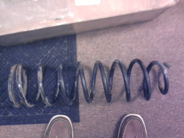

My FJ80 coils arrived today. They are the 8 wraps and they are quite large. They came off a Land Cruiser with a towing package and stock 31" tires. Once i get them on ill let you know how much they lift the truck. Hopefully they don't lift it too high.

Please do, mine are on the way and i have no idea how many wrap they are. Hope the 8's arent too much (is there such a thing?)

I don't mind a slightly higher lift, I just don't have money for longer shocks and all the other stuff that starts needing to be replaced when you go higher than 2-2.5". It is not a DD and its a budget trail rig though so either way I can't wait to get them on.

my FJ80 coils are about 20-1/2" long and more tightly wound than those on the yota forum
