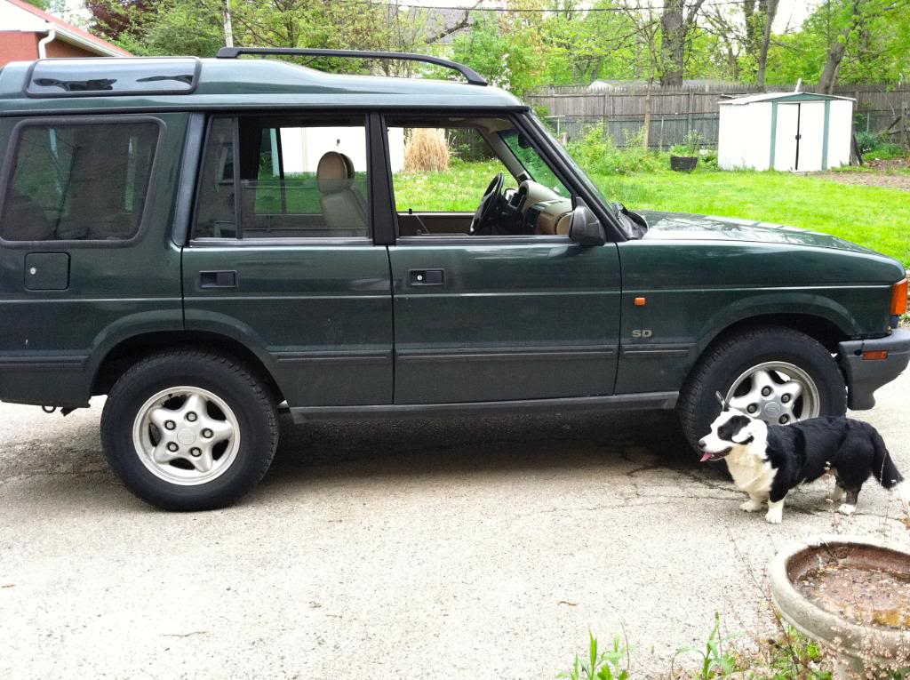

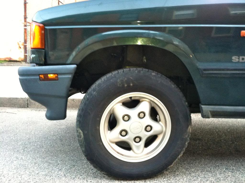

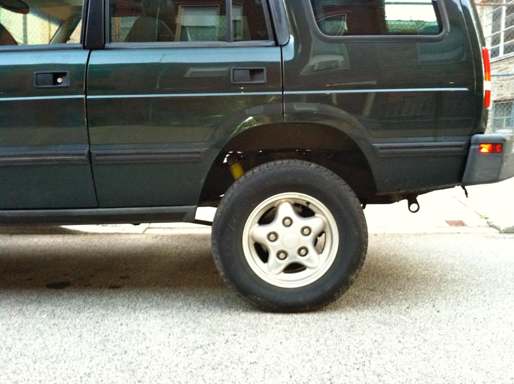

OK, so here's the deal, wasn't an hour and a half deal for me, but i think some of that was the trucks fault and some was mine. I wasn't on anything that even closely resembled flat pavement, so it was really hard to get the axels to droop far enough to get the springs out, they were all a pain in the *** so i used a spring compressor. here's my ride height before.
initially i was getting 31.5" to the top of the front wheel well and 31.75 to the top of the rear wheel well

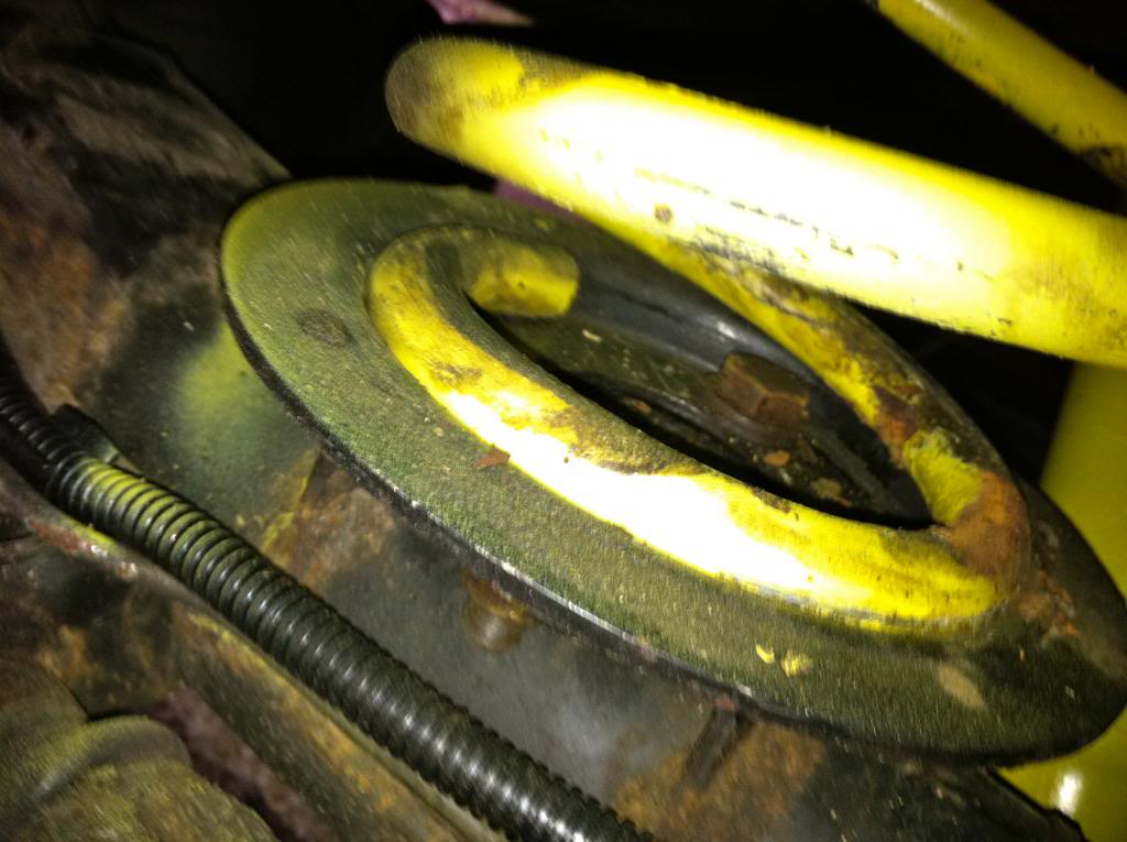

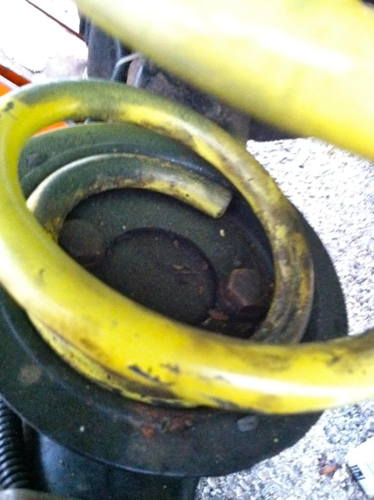

Here are the rear spring bolts i was whining about not reaching over the retainer clips when you flip the spring cup

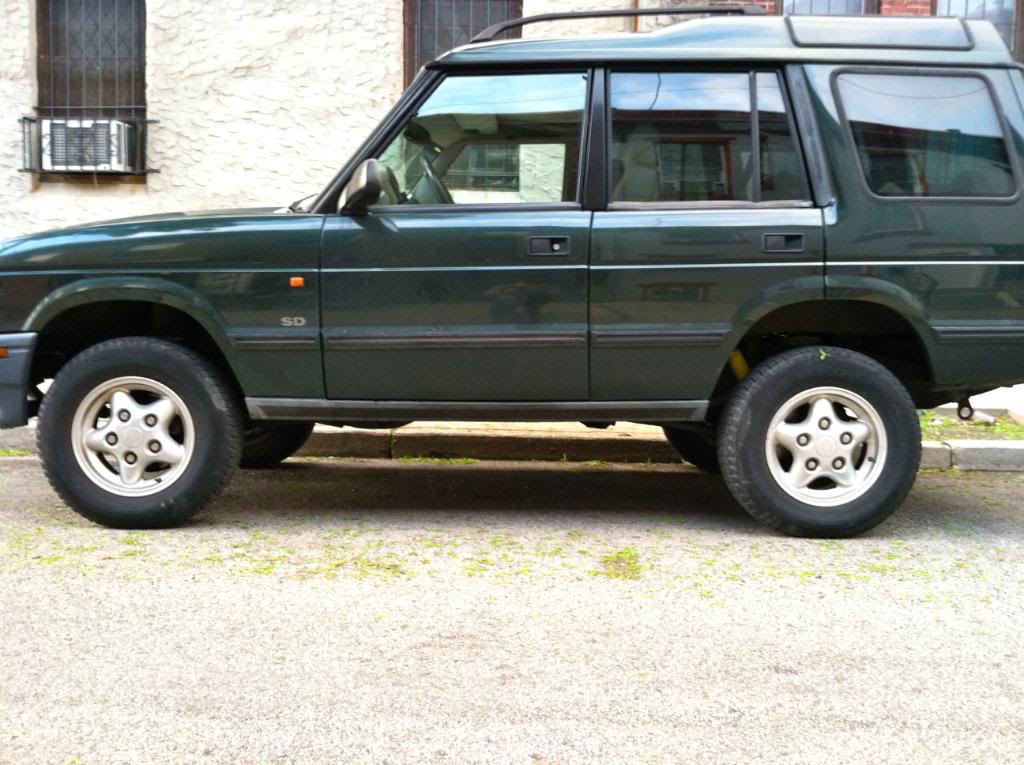

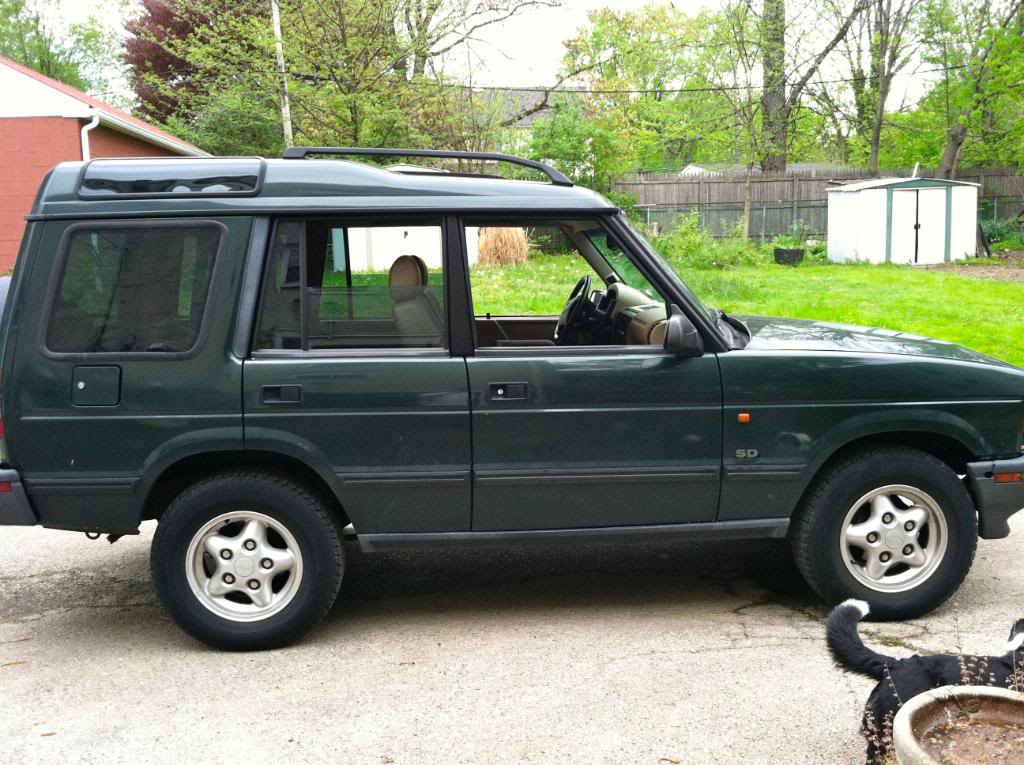

and heres the final product sitting higher in the back than the front about
33" in the front and 34.25 in the back, so its got a bit of a rake but i think that'll settle.

Its not a bad lift option compared to shelling out $500-$700 for a kit is it?. Looks good, you must have gotten taller FJ80 coils than I did because you definetely got a little more rear lift than I did on mine. Like I said, once the rear settles OR you start loading gear in the rear for camping/wheeling it should sit nice and level, besides a little rake to me is better than having a nose high ride IMO. Looks great, now either get longer shocks or make/buy some new shock mounts so you can get more shock travel becuase right now I guarantee its your shocks that are limiting your ultimate Articulation. By the way, my FJ80/ cheap bastard lift combo lets me flex out more than my buddys RRC with a 3" OME lift kit. We've both tested on a ramp AND in real life on the trail he was trying to drive up and over a large boulder with his front pass tire and the rear pass tire would lift everytime and start to spin, he had to bump the rock hard and let momentum carry him over. I idled up to the same rock, put the same right pass tire on the rock and crawled up and over, my rear pass tire stayed on the ground the whole time and I never spun a tire.

Yeah. I can't tell if it's because the new springs were longer or if my originals were so beat. Either way explains the rake. I'll BOLO for some new shocks but exhaust and tires win on the priority list at the moment. (and I guess it all pales in comparison to re-installing the retainer clips)

Take your old retainer bolts into a hardware store and just buy some longer ones of the same diameter. I always buy 2 new lengths just in case you get the ones you "think" will be perfect and they turn out to be to long or to short, toss the extra ones you dont use in a coffee can, they ALWAYS come in handy at some point. Yeah I have 245 75 R16 MTR's because I got them cheap, but I wanted/want some 265's. Unless I find some aggressive 265's for cheap I cant justify buying new ones when the 245's I have are damn near brand new and are mud tires. I find used 265 street tires or All-terrain tires all the time, but I think a slightly smaller tire thats an aggressive mud terrain(like mine) is better than a slightly larger tire thats a street tread or just an All-terrain.
