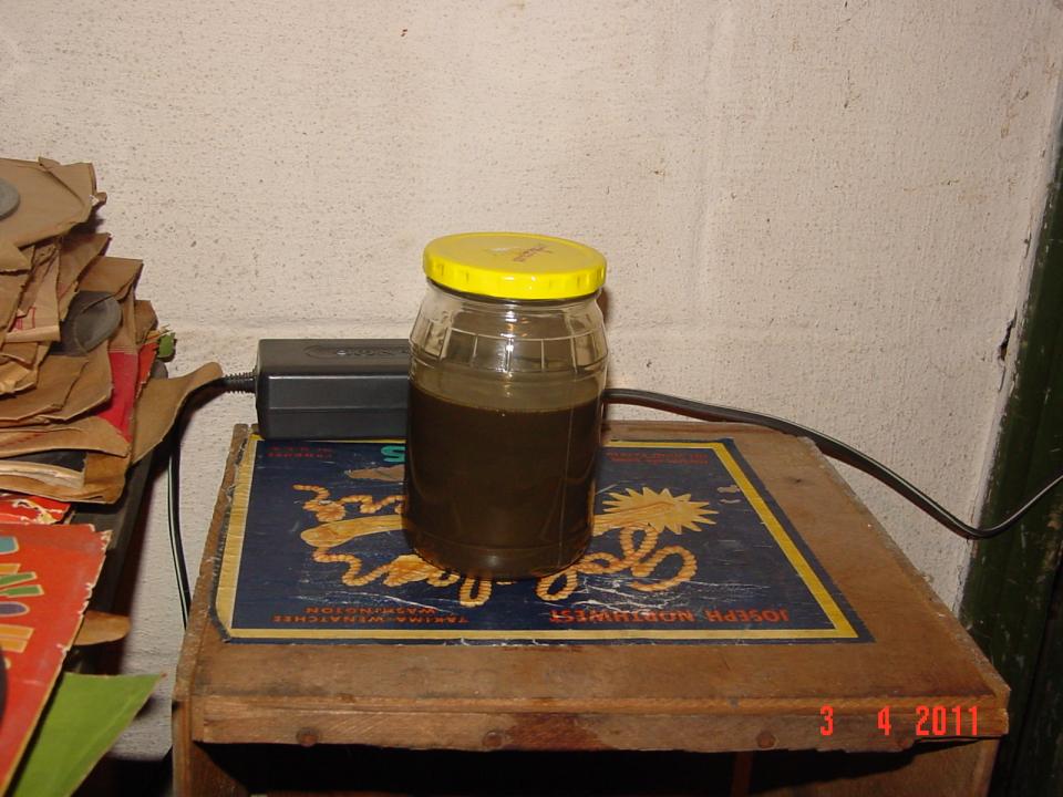

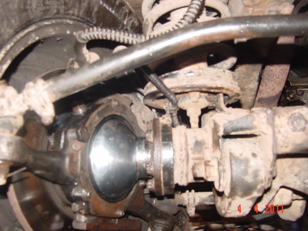

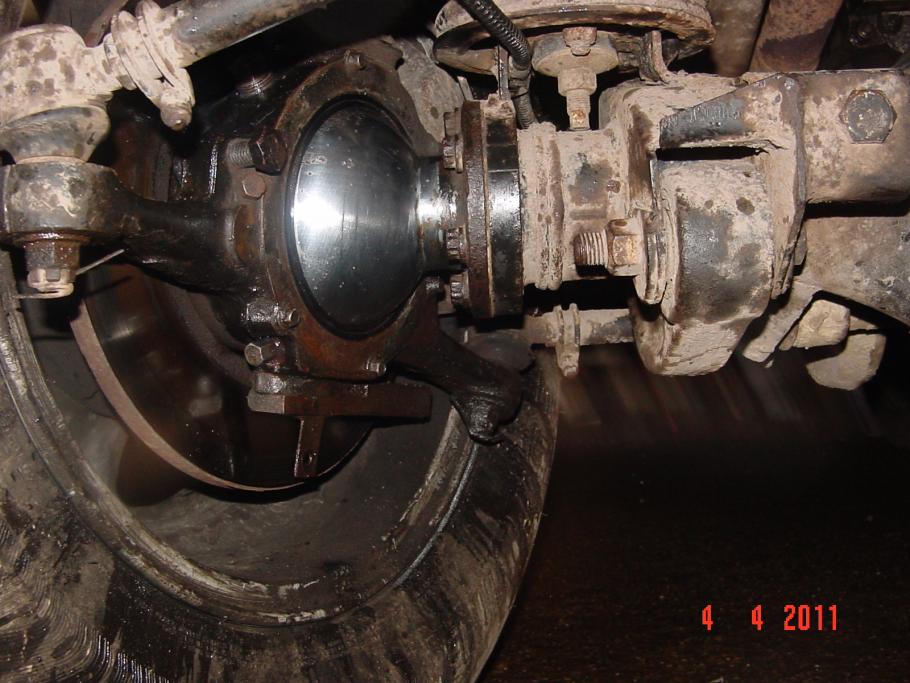

Here's some pics ofthe swivel ball for those that asked.

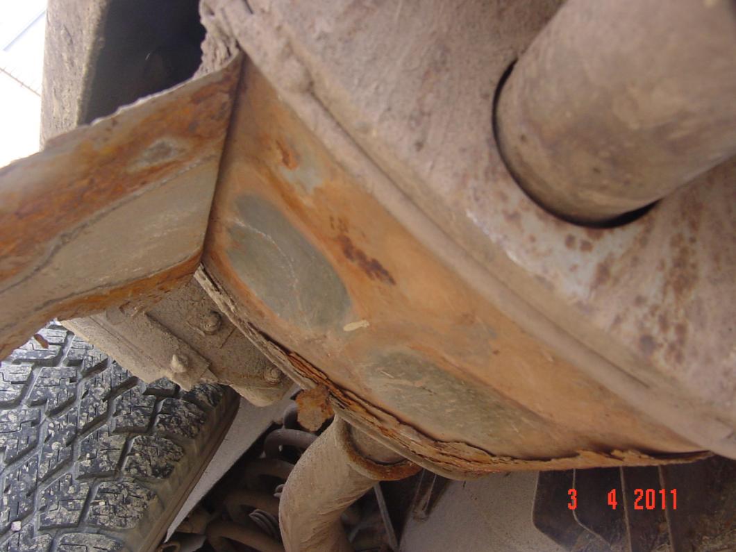

Two pics of swivel ball area, the stuff in the jar is what I drained from the right side swivel and one pic of my rear silencer as it is coming apart. I cut the flap off with tin snips. The other pic is my reflection in the side window during a rainstorm.

My center muffler was pealing like that, I used banding to hold it together for a year and then I went to the local muffler shop and they welded in a new muffler for $100 out the door.
Now my truck is so quiet I can hear all the other noises I couldn't hear before, not sure if that is good or bad.

I am thinking about cutting it off and throwing some cheapie back there.

Its at the back so just straight pipe it.

As you can probably tell, I took some extra time and sprayed the entire area down with Mean Green and wiped it all down to get the built up gunk off. Makes a heck of a difference when trying to get stuff apart.
You can clearly see the drain bolt and the square drive fill plug in the pictures. Swivel was still nice and shiny except for minor pitting up around the edges.
