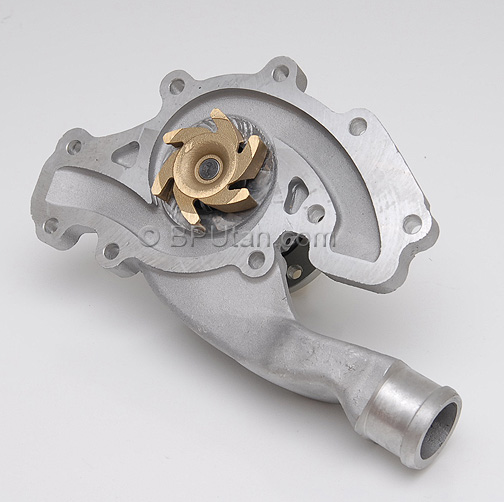

Pix of related items, radiator is not a D1, but shows the idea of sludge blocking tubes, Ultra Gauge on the world's champion mpg Disco, high flow water pump from BP Utah.
