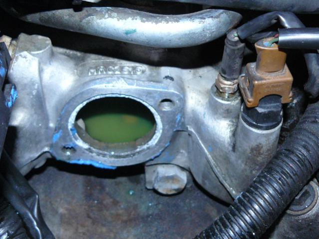

F. If you changed the thermostat, on a D1 it would go in this hole, the spring end fits inside the block. A 180F model is available, which is what I run because I don't live in the frozen North. A D2 has an external thermostat inside a big plastic chamber, you can also get a 180 model for those.
