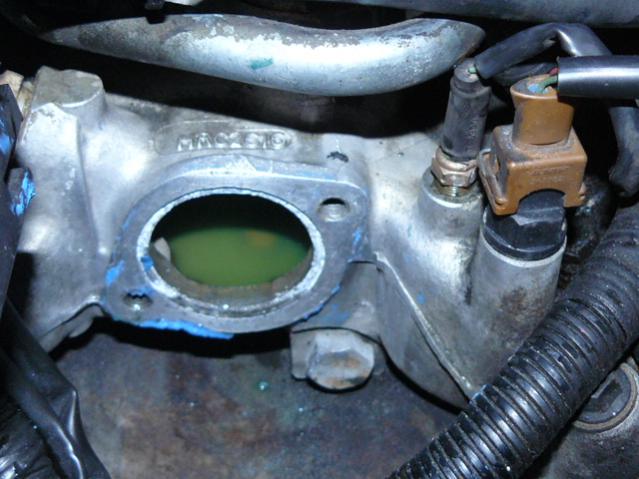

The two sensors are shown in the pix, gauge is on the left, square top is the ECU sensor. A ground (skinned place) on the single wire can cause the gauge to read hot. Or green goop on connector. From RAVE:
The Engine Coolant Temperature Sensor (X114) has
approximately 136 ohms resistance when the coolant
temperature is low. As coolant temperature
increases, the resistance of the sensor decreases.
This varying resistance causes the current through
the sensor to change and the gauge to register the
temperature. When the coolant is hot, the resistance
of the sensor is approximately 17 ohms.

And back to the cooling issue itself: why such a change from last night, when (similar ambient temps) the UG read around 212?
Since 212 is boiling I would be very concerned.
I agree a shorted or skinned wire will give an overheat reading on the guage but he has a lot more than that going on. Very many more episodes of 212, that block will go really well with the round glass table top I have.
