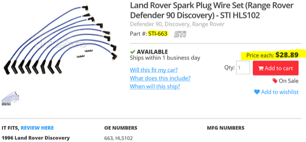

Back to the plug brand, I like STI.....they never give me an issue. As for plugs, it's NGK only for me.
> https://www.fcpeuro.com/products/lan...hls102#fitment

I just ordered the plug wires you mentioned with their life time guarantee.

This just in ...... those ignition wires WIN the POS of The Month Award.
All the box is missing is a Britpart or Allmakes sticker.
I know you will like the Karlyn/STI wires.
Have a look if you want more info about Karlyn Products > Karlyn/STI Spark Plug Ignition Wire Sets
