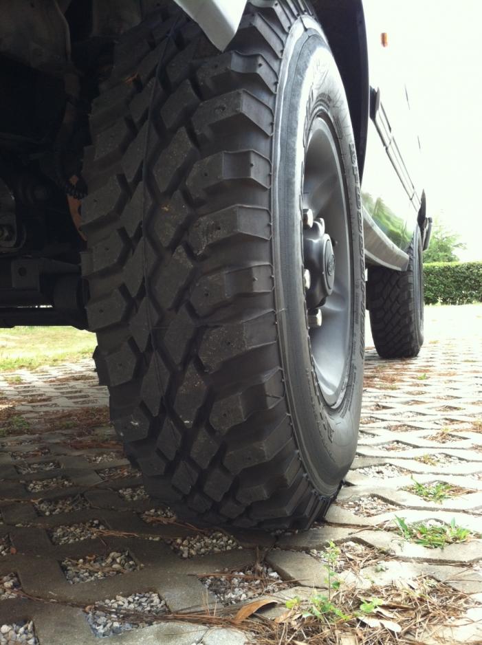

Maybe these pics will help someone else when shopping tires...thanks to Street Wolf for posting pics of these on his D2 because I was struggling to buy them based off of Treadwright's stock photo alone.
Info: these 235/85/16's are 32" tall. I've got a OME 2" (really 1.75ish) lift and needed the "camel cut" to stuff (done horribly but will clean up soon) and obviously have trimmed the front bumper - all necessary to clear tires AND have flexibility for off-road IMO.
The spare fit with a whole 1/4in to spare! Only slight rubbing at full lock so I will have to adjust the steering stops but haven't rubbed during daily use.
1st week review: was surprised at the minimal road noise, this is my daily driver and there's a slight hum to them, but I have to listen for it with the radio off. I was expecting much more of a mud tire road noise, but pleasantly surprised.

Definitely look better in your pics than treadwrights. Glad to see the post, I just ordered these, same size and all. Also glad to here the spare fit. Thanks

What will give you even more traction with those tires is to sipe the 2 inner ribs, this will great improve water, snow, ice and wet slick rock crossings.

They do look good. The 235 width with the extra height can be much better than a wider track in some applications. Does it increase the ground clearance for the diff's?
I agree, I personally like the skinnier/taller tire on Rovers - I feel they look more "proper".
I've gained 1.5" of diff clearance since these are 32" tall and stock is 29" I believe.
