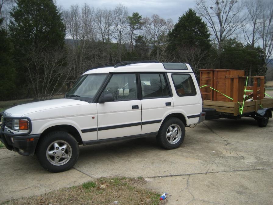

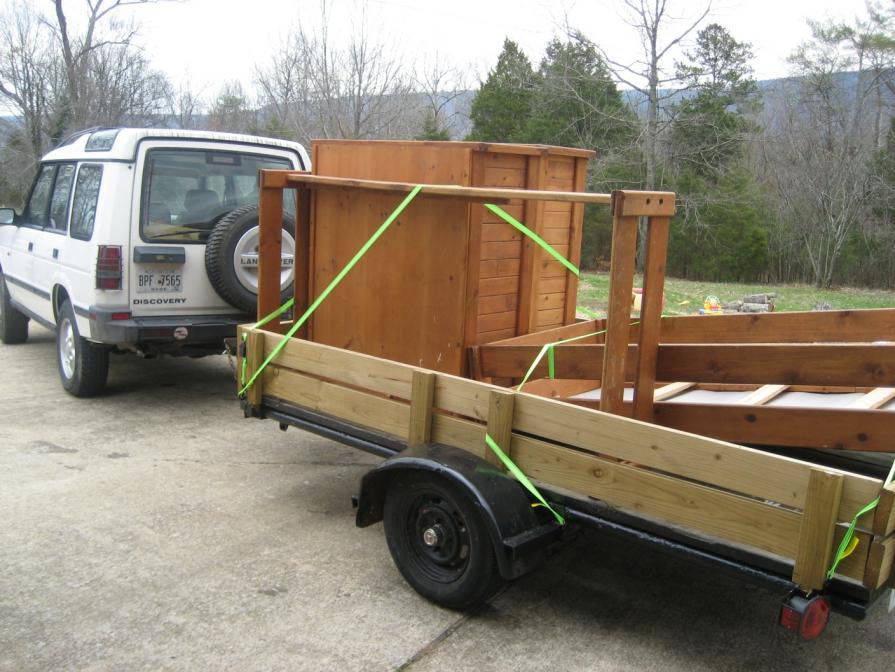

Correct. It would run like crap with the original ecu, ran at first with the replacement, but then stopped working (locked out) But ran again with their test ecu... ??? Anyways, it seems to be working great. I just did a 2 hour round trip in it pulling my trailer to go and get a big wooded bunk bed setup. It's still a little rich, not blowing smoke rich, but o2 sensors need to be replaced rich.
Went though about 8 gallons of fuel. Can't really be totally accurate there, cause I can not fill up the tank, but I had a quarter tank, put 10 gallons in and when I got home I was above where I had put the 10 gallons in.
google maps says-
I-59 N and I-24 E
57.6 mi
so say 120 miles round trip total, and around 8 gallons of fuel... thats about 15 mpg...
Livable, but should do better with the new o2's. It's just rich enough right now where it kind of burns your eyes to drive it...
I attached a few picture of the load...
Attached Thumbnails Plug Fouling 96 D1. All plugs.-towing1.jpg   Plug Fouling 96 D1. All plugs.-towing2.jpg
