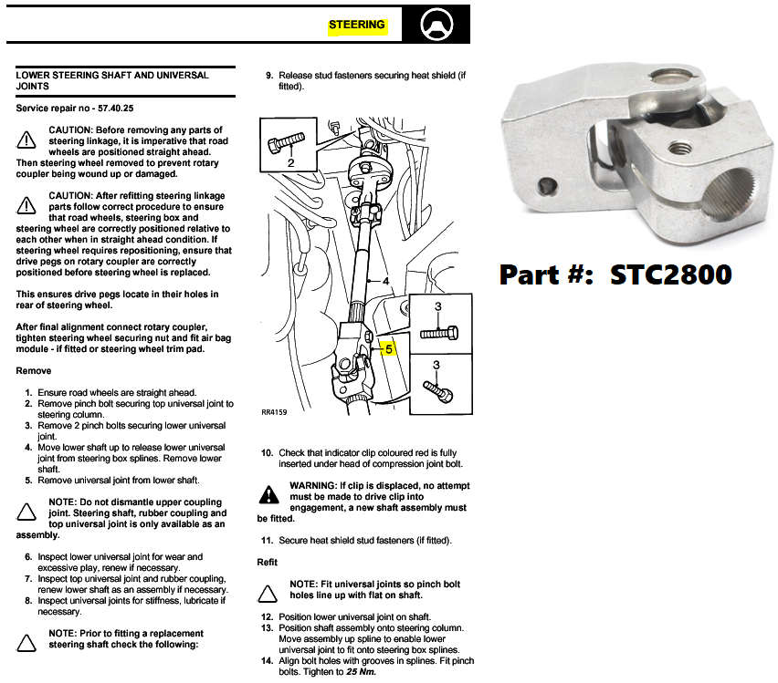

Another part(s) to inspect are the Lower Steering Shaft U Joints (especially the lower).
The joints are not greasable and if worn they can make a pop/click sound when turning. I had that happen on a '97 and it drove me mental.
If you have the original steering shaft the U joint is replaced with STC2800.
