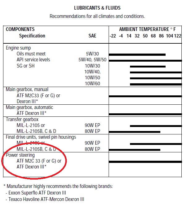

ATF is recommended over Power Steering fluid? I had not heard of that.
yep, you should be using ATF.
Attached Thumbnails Power Steering replace lines and fluid flush?-fluids.jpg

Originally Posted by philwarner
In an old thread disco mike advised for a flush of the power steering system " You'll need 4 quarts of P/S fluid, a Bottle of Lucas P/S additive and a turkey baster, hand pump " I am not ignoring the recommendation of ATF, but am curious about the recommendation of Lucas P/S additive and P/S fluid. Would that be the Lucas Power Steering stop leak I am trying? Are there seals that are damaged by P/S fluid?
I'm not knowledgeable enough to answer those (good) questions in any authoritative way.
The power steering system is isolated. it doesn't 'touch' any other systems (thankfully). If you are having some leaking issues (everybody does eventually) I (if it were my truck) would drain and replace with ATF, run it for a week, then drain and replace again (with the goal of getting the greatest portion of the PS fluid out and having nearly all ATF in there.
If it still is leaky you have a choices to make... a) change the seals in the steering box. Some have success, others report continued leaking. b) change the entire box. c) add a 'stop leak product.
Mine was leaky and I added Blue Devil Transmission sealer (note...not PS sealer)
Amazon Amazon
which seems to have worked. It won't ruin anything that I wasn't going to replace if it didn't work anyway so I figured I give it a shot. So far, so good.
I wouldn't advocate for a 'stop leak' product in the engine or cooling system because the downside (clogging/blockage) can create more problems.
