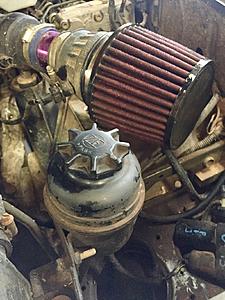

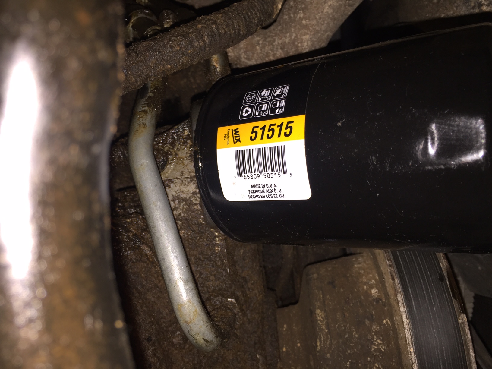

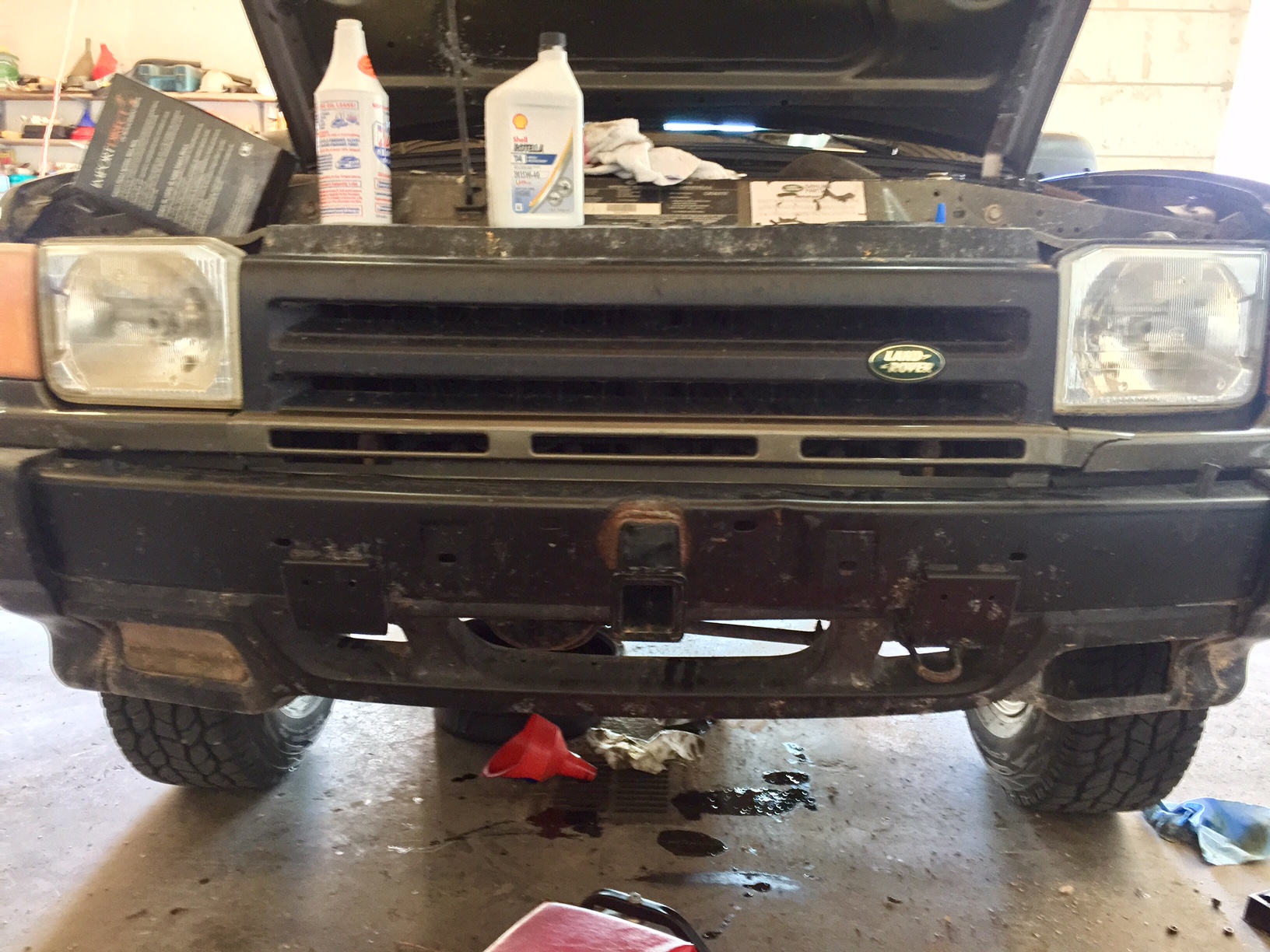

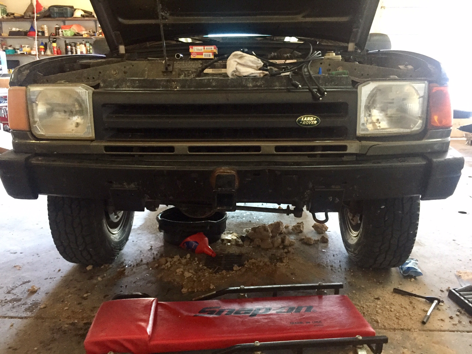

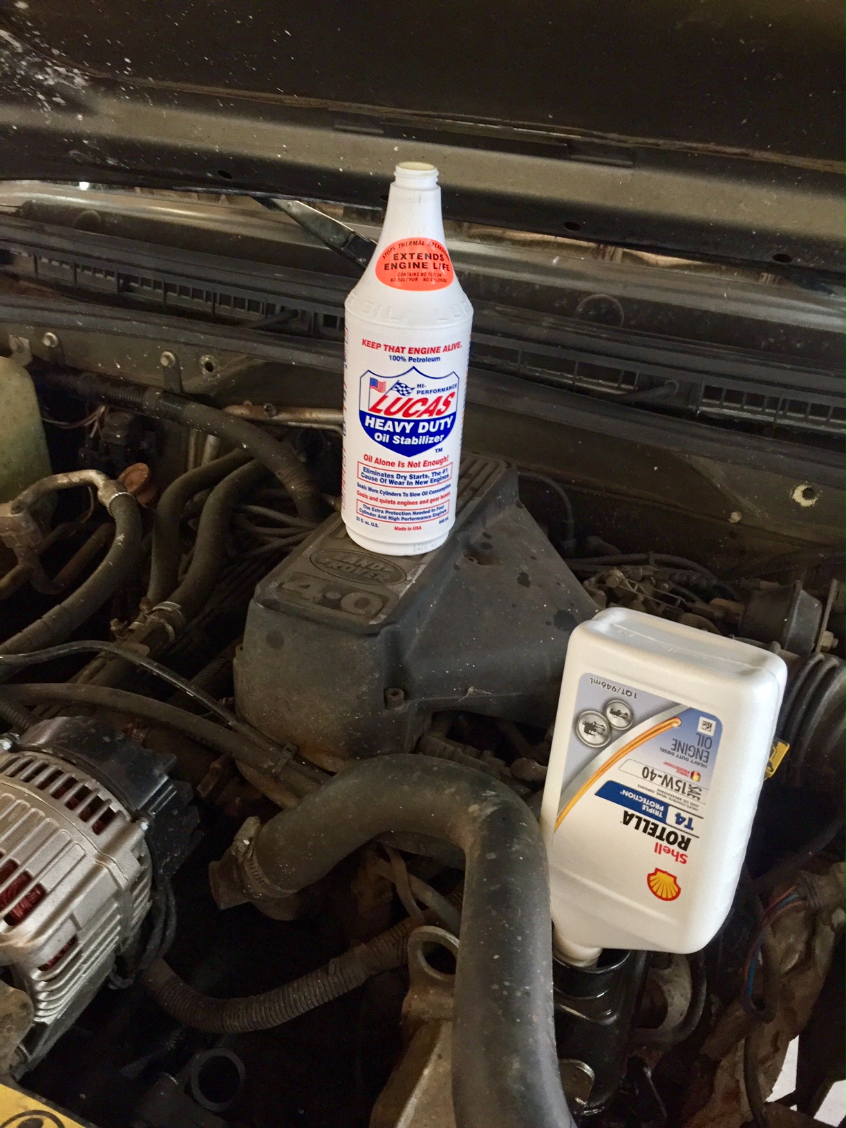

So, after waiting a week for parts that were never shipped, I ordered a set of plug wires from O'Reilly's last night & picked them up this morning. Of course, they had the plugs & filters in stock (Wix too). So, I started off with the oil change. Not my proudest moment, but definitely nowhere near the biggest mess I've ever made changing oil. Butter fingers happen to the best of us. The fuel filter brought a future repair to my attention: the fitting will not turn freely on the tank-to-filter line. It doesn't leak, but it took forever to get it off. Did I mention there's still a metric tonne of Texas panhandle caliche still stuck to the bottom of my truck? Well, now it's only a half a tonne... Then I cleaned the "air filter". I won't go on a tirade about cotton gauze air filters. BUT, WAIT! THERE'S MORE!!! I'm just saving it for the end.

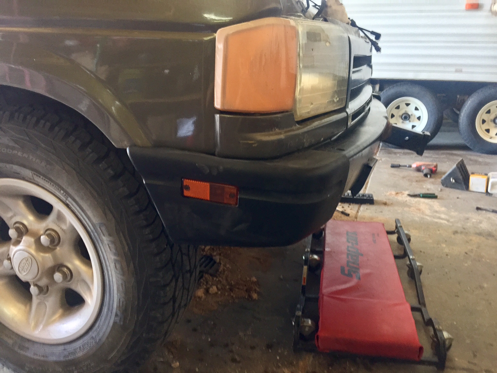

Did a bumper mod I saw on here, but I can't remember who I stole the idea from. If the original poster will claim the idea, I will thank you. (Also, anybody need a mostly good D1 air dam? It'll be cheap.) Removed the air dam & corners, cut corners, Armor-All'd & reinstalled. I like it. Haven't rubbed a tire pulling into my steep driveway yet.

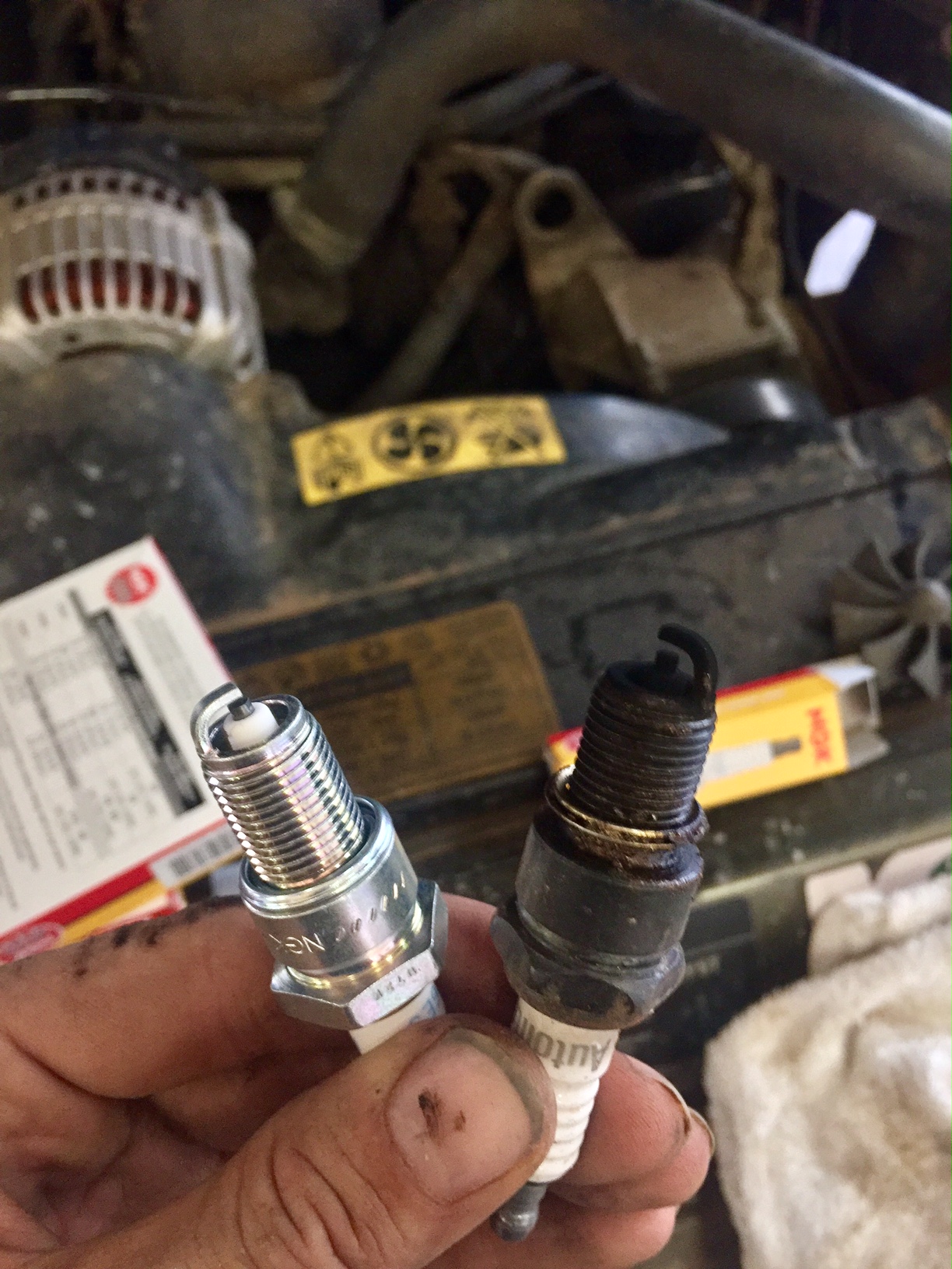

On to plugs & wires. How hard could this be? I mean, they are pretty much in the open & easily accessible. Every single one of the old Autolites (Fram) were gapped to .045-.050" & fouled. New NGKs set to .038" & wires made a tremendous difference. As did cleaning the IACV. It was all going so well, until I tried to snap the wire onto the #8 plug... For over an hour I pushed, cussed, switch hit, etc. until it FINALLY went "click". I have no clue why that is the only cylinder that gave me problems. Got it all done, and Coco runs great. I'm set for a while.
Now, to the air filter...

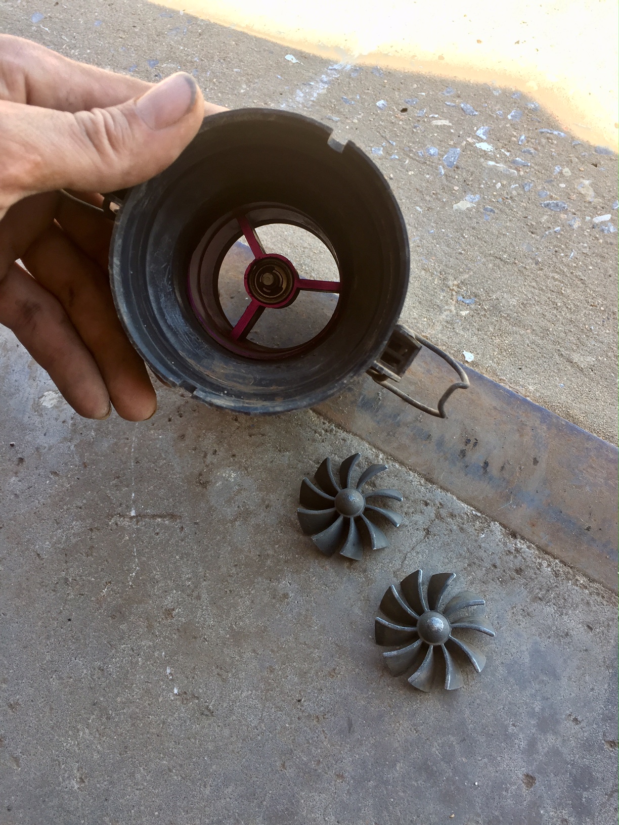

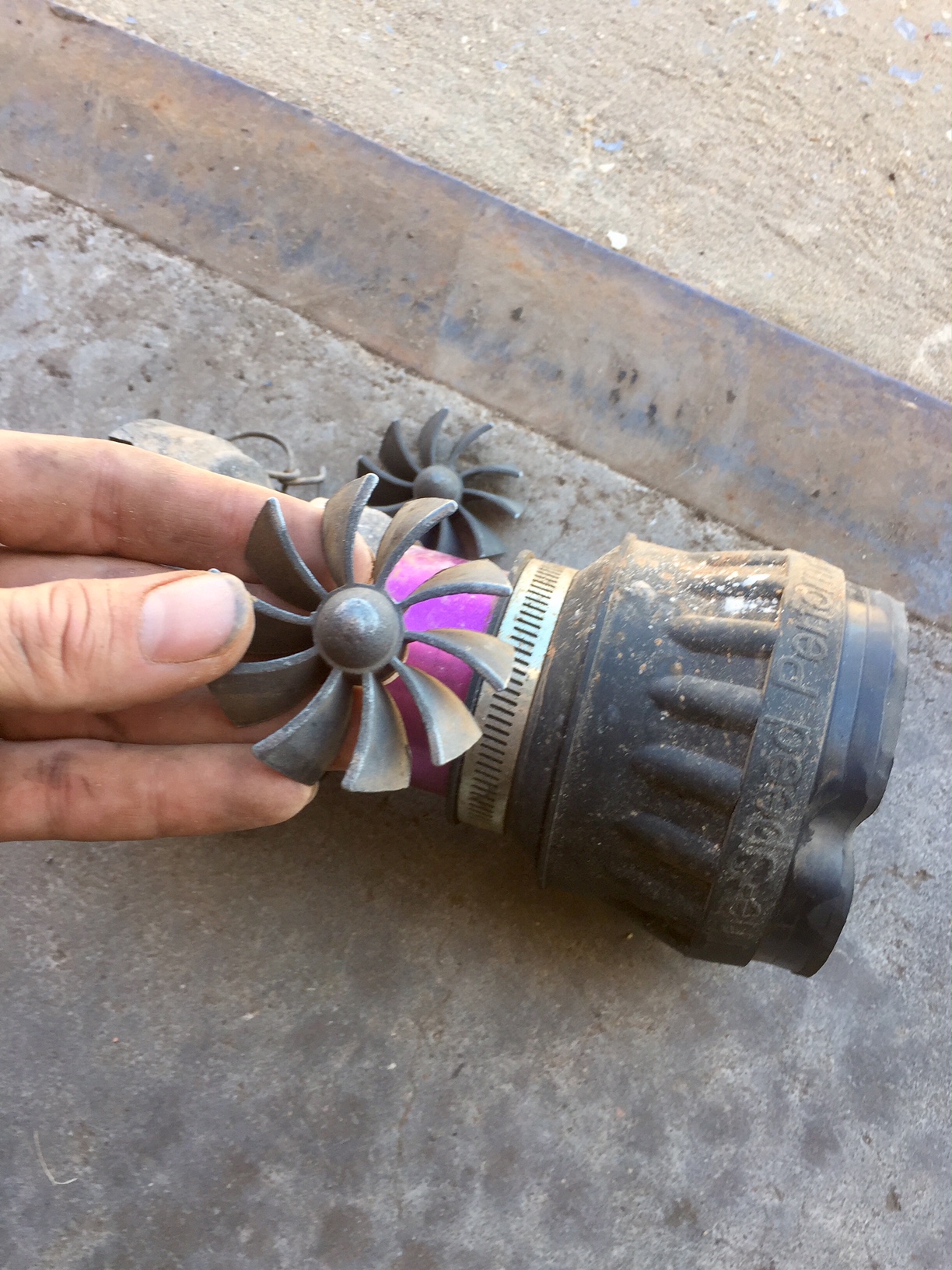

So, I think my turbo went out... Has anyone ever seen any BS like this before? No wires. No motor. Just a bearing shaft & 2 unattached impellers. I am getting a factory airbox in the very near future.

" Now, to the air filter...
So, I think my turbo went out... Has anyone ever seen any BS like this before? No wires. No motor. Just a bearing shaft & 2 unattached impellers."
Those stupid B$ turbine/tornado air filter add-ons have been around forever. Adds 8 to 10 hp..... NOT.... Just a total waste of money.
Like> Chevrolet Performance Turbo Air Intake Cone Filter With Free Supercharger Fan! | eBay
Old Oct 14, 2017 | 04:28 PM
RedneckHippy's Avatar
Joined: Sep 2017
Posts: 23
From: OK
HAHA! Right? These impellers are cast metal. I used to machine something similar for a couple years. A buddy of mine bought the tornado (non-moving) for his '87 C10 years back. He said it really did help 1-2 mpg on the highway with that pump sucker. I've never seen one that actually had a bearing.
Old Oct 14, 2017 | 04:44 PM
OverRover's Avatar
Posts: 2,514
Likes: 656
These things are just funny. Sad part is look under the hood of some 19 yr olds Acura or Honda and you'll find one. My Dip$hit 16 yr old nephew bought one and was convinced it made his Mazda faster. Poor kid is not the sharpest tool in the shed.

LOL! Is it supposed to use the intake charge to power the impeller to force more air into the engine? The original tornado was just a bunch of aluminum fins that supposedly created more turbulent air for better fuel atomization. Supposedly... I mean, that sounds like there might be something to it in an old TBI Chevy. This thing, I'm still wondering WTF?
I just want a paper filter to keep the dirt out of my engine. Is that too complicated for kids these days?
Old Oct 14, 2017 | 06:13 PM
OverRover's Avatar
Posts: 2,514
Likes: 656
" Is it supposed to use the intake charge to power the impeller to force more air into the engine?"
In "theory", yes.....but no science just marketing. A tiny "supercharger", not going to get it done. IMHO this thing falls in the will it help...NO, will it make someone FEEL like it makes hp probably. In the end it's just another product to liberate money from your wallet. A quality paper filter works very well in a DI.
Works great, no?
