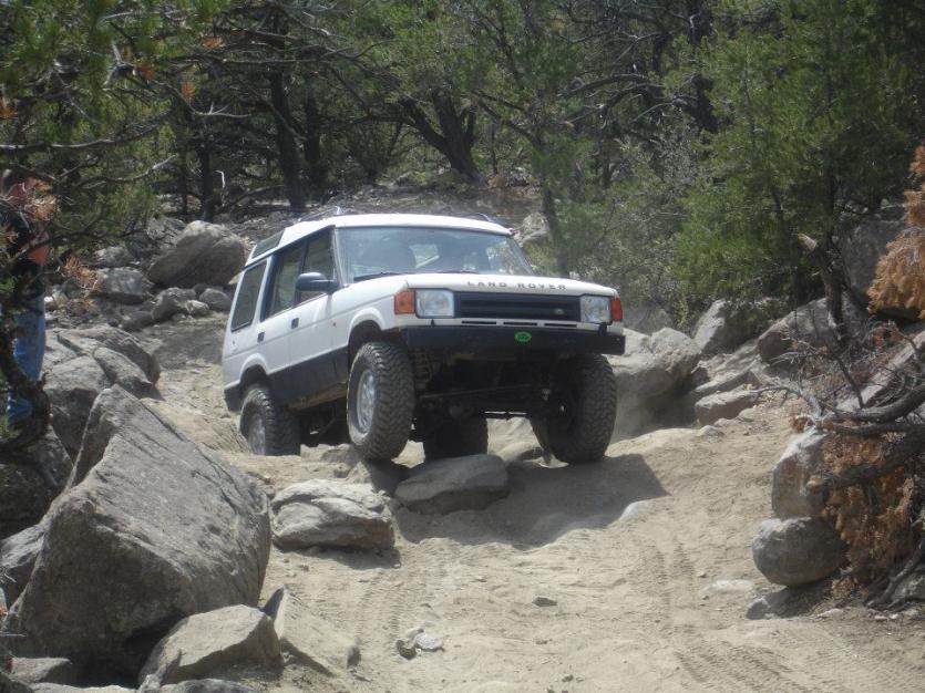

Has anyone Used this Proline Kit to eliminate the Flex coupler. I Have just started getting into some actual rock crawling stuff and with the money I've spent on Flex Couplers I could have bought this.
The other option is a Double cardan. I've got a 2" lift would this be too much over kill or well worth it.
Here's a pic. I'll post more. Wheeling Chinaman Gultch loop in Buena Vista Co
