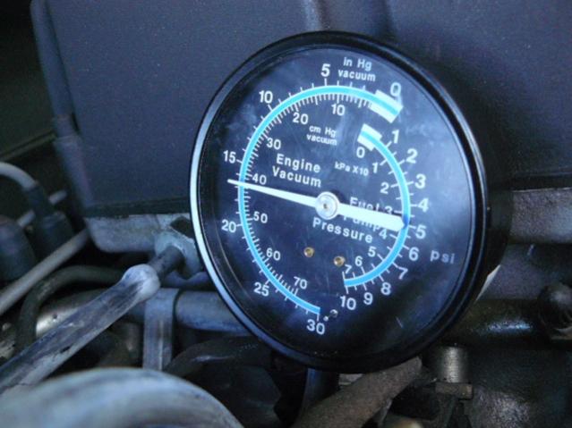

Well that would be 2 different gauges most likely. You can hook up to a vac line, and there is the fuel test point on the passenger side fuel rail. I'd advise and electric sender, no point having fuel under pressure squirting out from the dash. Here's a vac gauge from my tool box. Yes it will measure FP, but not like ours (30's) and certainly not like Mercedes (two pumps in series for 70+ PSI). Cars used to come with vac gauges built in.
