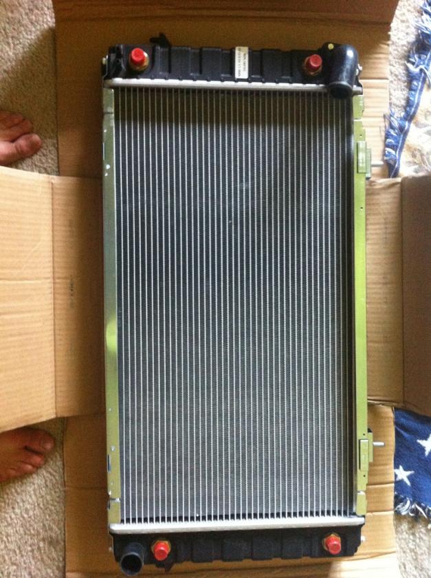

Yes, I saw that one, but the description is a bit confusing. One part says copper core & brass tank, and the other says aluminium core & plastic tank. Not to mention yes it has the tranny cooler & oil cooler, and in the same description, it says WO/EOC & WO/TOC. I dismissed it based on that.

Here is a pix of what our other member received. Has the coolers. At that price will have plastic tanks. Each oil cooler line has an o-ring, which might also be source of your leak.
