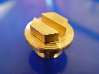

You might also consider up-grading to a bronze plug like many of us have on both diff fill plugs and your radiator plug.
British Parts of Utah has them.
