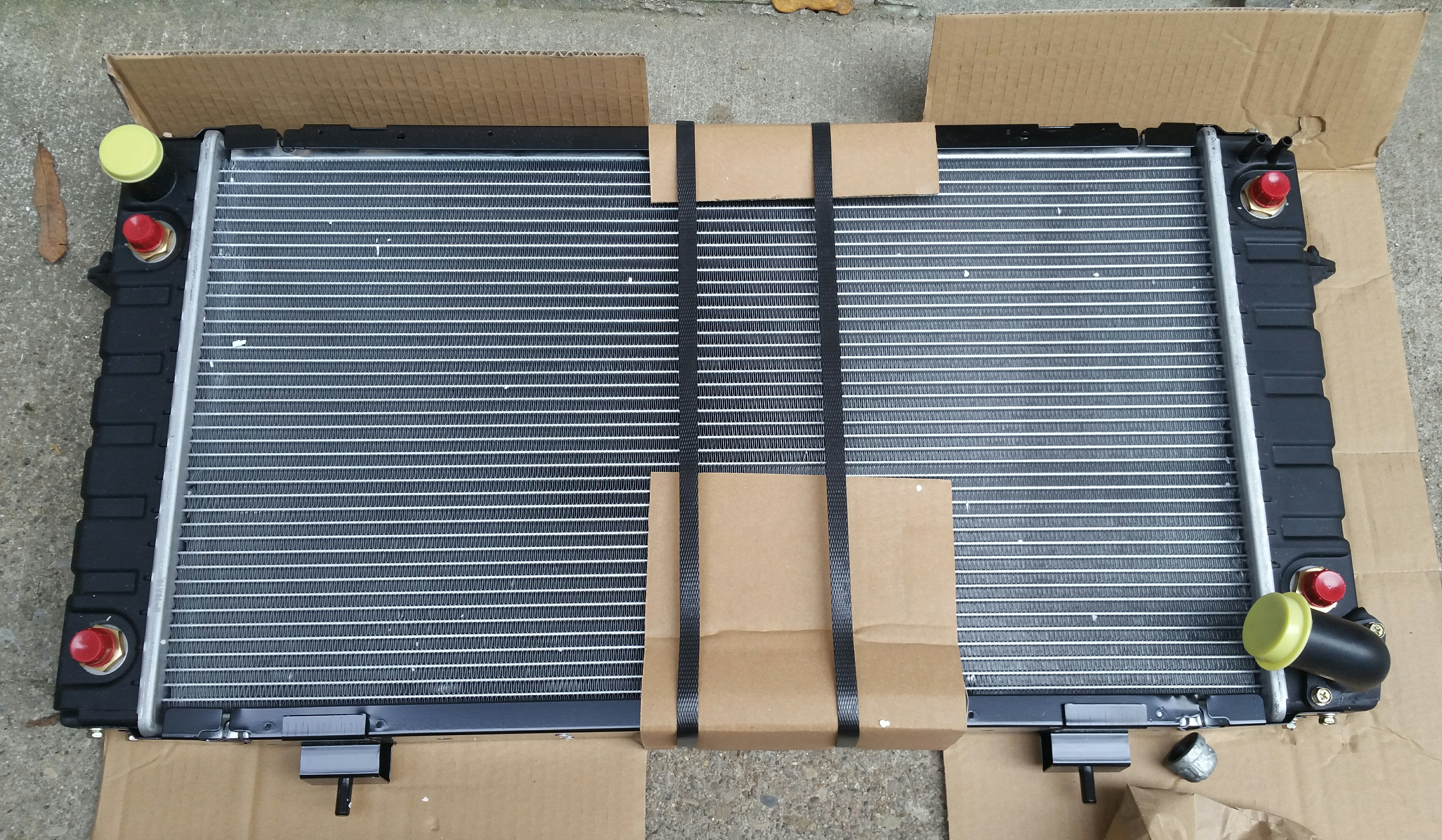

So picked up the Nissens rad yesterday for my 5speed. What can I plug the AT cooler with? Does it need to have caps on them or will the rubber plug in it suffice?
Thanks
Old Aug 17, 2018 | 10:15 AM
  #27
Toran's Avatar
Joined: Sep 2015
Posts: 1,125
Likes: 77

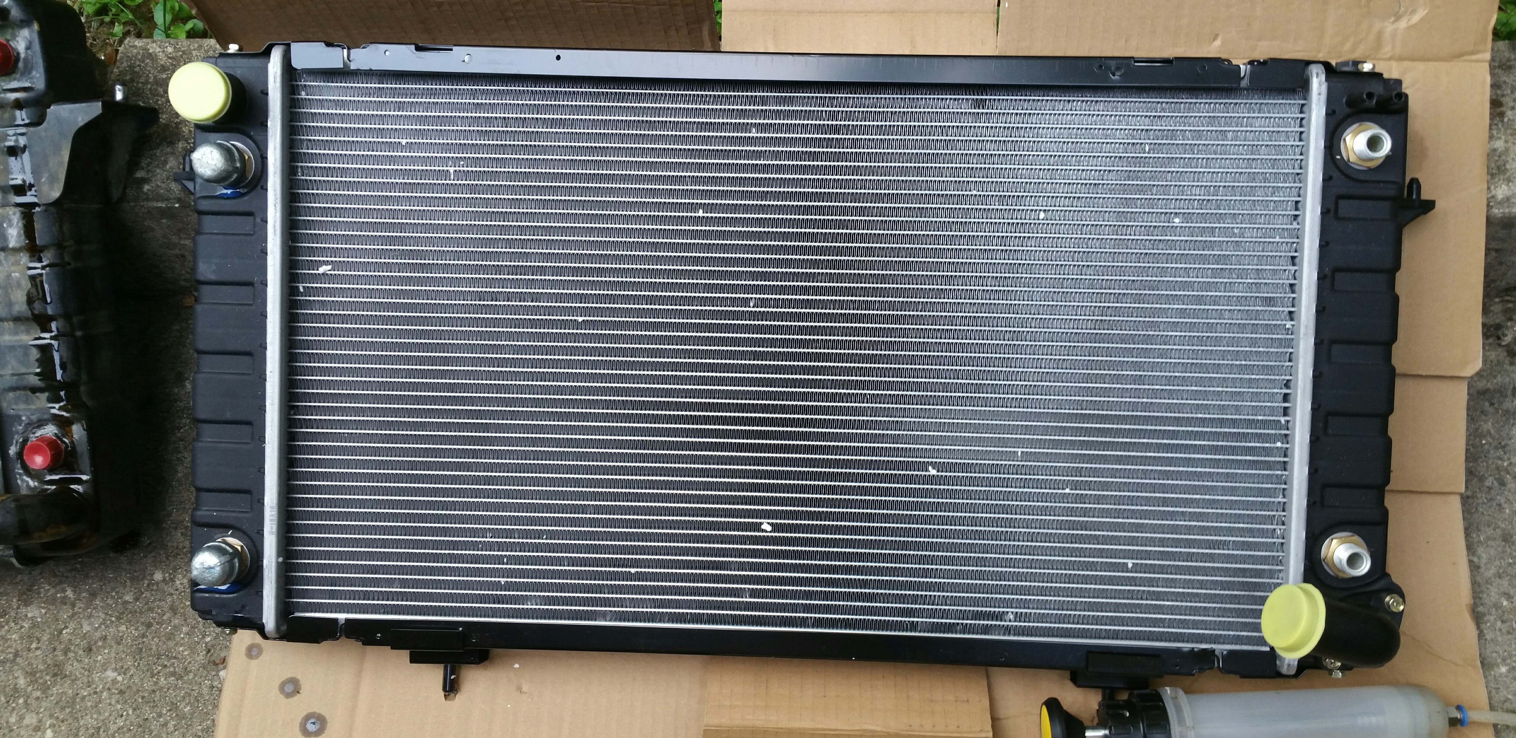

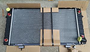

Mine arrived last week.
I dont trust those plastic caps, so took the radiator into the hardware store and picked up these pipe caps. The radiator has pipe threads. I dont recall the size so take it with you.
I also put some locktite on the threads for good measure.

Nice! That's what I plan to do today.
