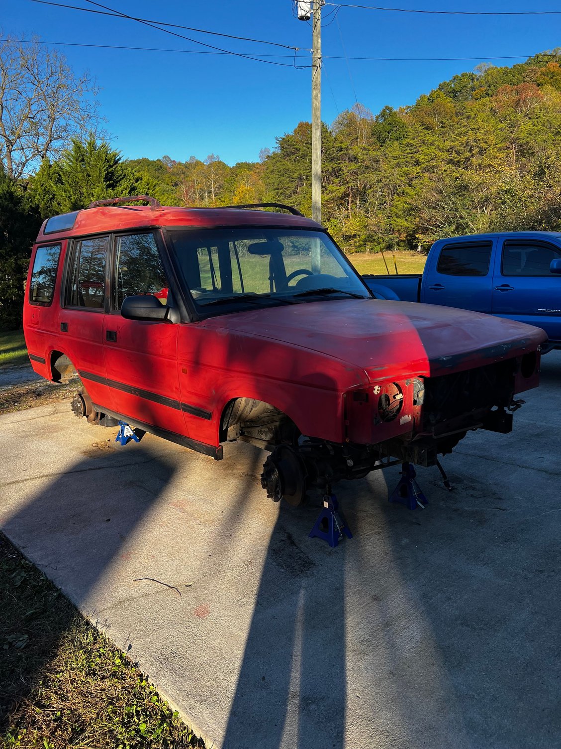

Also, here is the current state of the Resto Off Road build. About a month of ownership.
Never had such issues getting wheels removed 😉😂😅.
Thanks all!

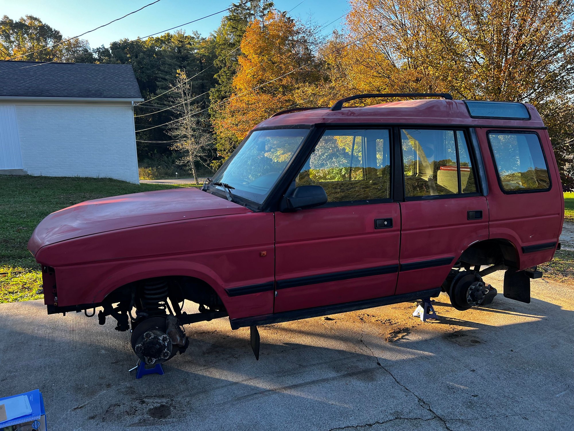

Shes sanded everywhere. Washed, and now I’m gonna fill the dents and get her as straight as possible before paint. Here is the current state. Fuel pump and fuel lines officially sealed! I also have all the wires and blend door cables on the way for the dash. This project is already in the thousands, I’m only 27. If anyone wants to donate a complete center console housing that would be awesome 😂😂.
Here are the updated pictures: A wash after week and a half of sanding.

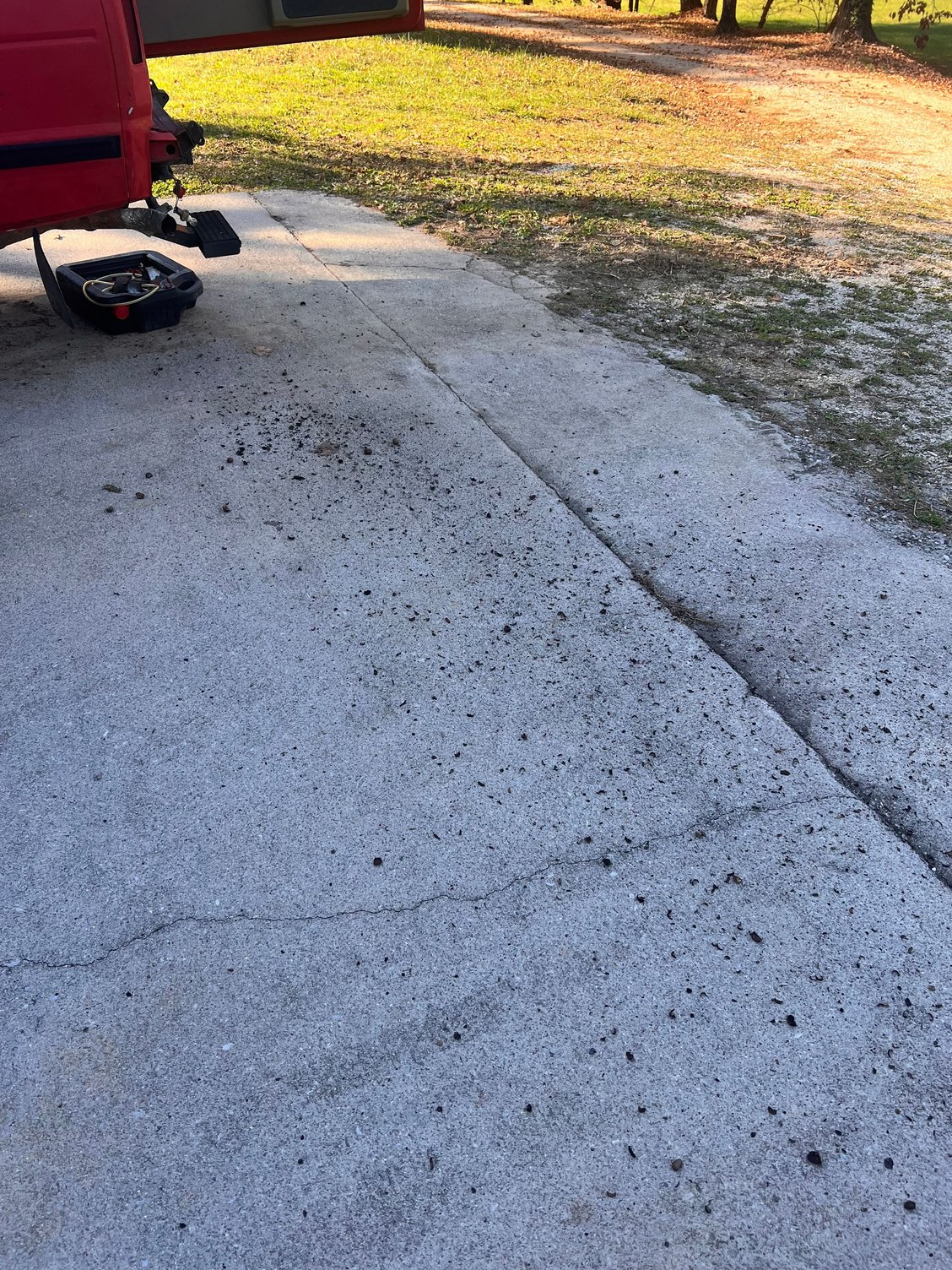

ALSO, I gave her some revs, and hilariously, the home of a squirrel or chipmunk came out the tailpipe about 50 feet. There is plenty more to fish out too, too bad the exhaust is getting cut 😉

Here is the current state!
