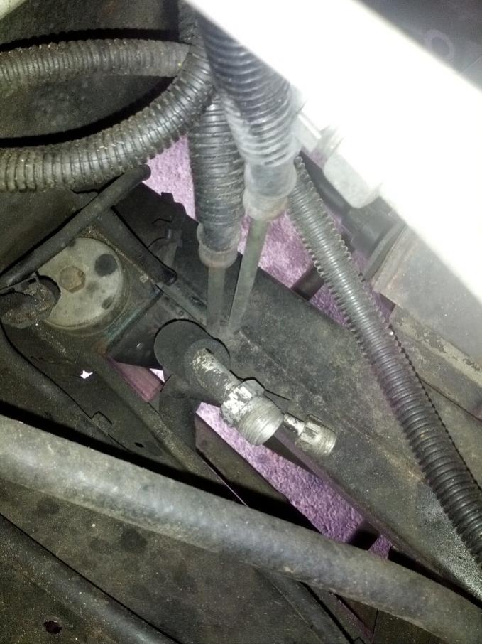

If you haven't already, you should download the RAVE manual, there are descriptions and drawings of the layout of the components (might be helpful) the a/c components are on page 751 of the RAVE manual.

Default found some capped off lines...
Saw these along the framerail of the starboard side of the engine.
Can somebody post a pic of where they hook up to the compressor? maybe I only need to replace these...

Yes I did, I will take a picture of where I did it soon and post it. Got them from the site I posted previously for 40$ and now I have ice cold a/c

I know this is an old thread, by I thought I'd jump in and share some information as I too have a leaking rear ac unit. Having previously done an rear AC block on my wifes minivan, I know where to get the part needed to perform this. It's easy as heck. I was able to find the part for our Discoverys on the same website. Here's the link for the part:
StreetRodGuys - Rear Air Conditioning Block Kits - Land Rover Rear A/C Block Kit
They're a bit pricey for no more than they are, but they work great. And, considering how much it costs to keep dumping freon into these things, it's well worth the money. The ones I placed on my wifes Caravan are still holding charge after nearly two years. For no bigger than these little Discoverys are, there's absolutely no need for a rear AC unit. So just working on the front should work perfectly fine to cool it down.
