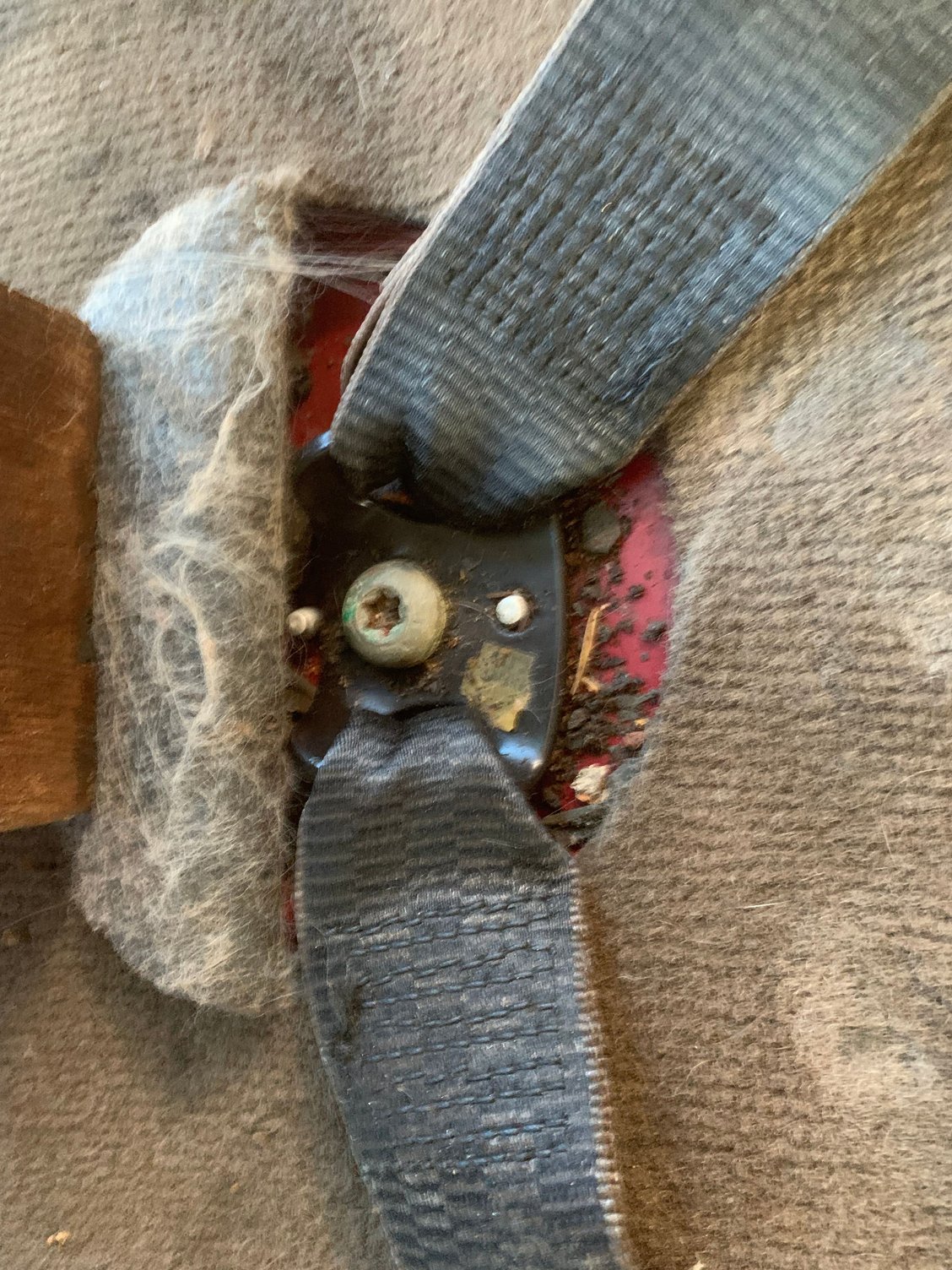

I recently bought a '94 D1, and the rear inner seat belts (center lap belt and receivers for shoulder belts) are not installed. I have the belts, but not sure what other mounting hardware might be required and how everything is attached. I located the holes in the floor that I believe are involved. I've searched around for an assembly diagram/parts list, but haven't found anything. Any guidance?

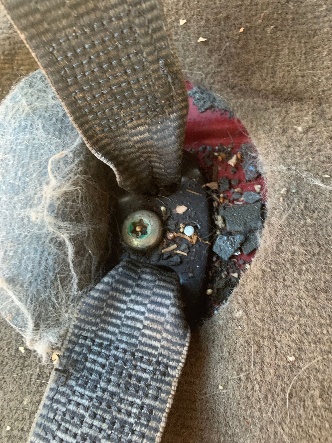

Bolts & hardware and that’s about it. The belts should be sewn into the metal brackets and you bolt these in. Nothing more, really. I have a ‘98 and am rebuilding it completely. I took photos for you.

perfect, thanks! That’s what I thought. What I didn’t realize, until I crawled under, was that there are anchors with captive nuts. Looks like in your pics they’re riveted in place. Mine were loose and hanging underneath. I was able to prop one up and get the bolt threaded but need an extra set of hands for the other.
