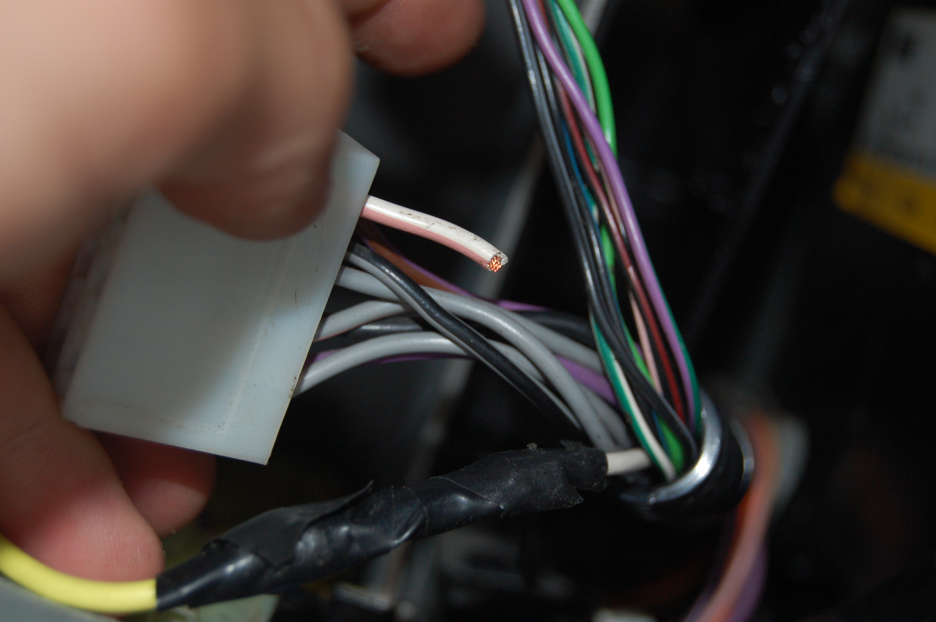

Here's what I've done so far with no luck.
Attached Thumbnails rear window ecu bypass-dsc_0010.jpg   rear window ecu bypass-dsc_0005.jpg   rear window ecu bypass-dsc_0007.jpg   rear window ecu bypass-dsc_0009.jpg

Default What does this mean? Electrical is definitely not my forte.
This is the test for both rear windows not working from the RAVE electrical troubleshooting manual. I understand all of it except what the box in the test line would be? I'm guessing I should just take a test wire and connect the D to the E wires on the back of that multiplug in the window ecu while disconnected.

Default Update
Sit rep:
Did the test from the RAVE manual. The box in the line (above diagram) is apparently a fuse, didn't have that so just used a piece of wire. Connected terminal D to E and bingo, rear windows work. Disconnected that test wire and they still work, don't know why but I'm not complaining.
Decided to take the AB spliced in bypass wire out, resoldered everything back to normal and that cured the blower motor and fuel filler flap.
All is back to normal now except for that the drivers window is non functioning and is fully open.
I guess I'll do the similar test from the RAVE electrical troubleshooting for that one and hope all will be well.
I've read a lot of threads on here which helped a ton! Thanks everyone.

Bump for an old thread. My issue is the same as the OP's, no White/Green wire on connector C2703. Is the point to supply power or ground to the White/Pink wire that was previously attached to the C288 connector?
Power, not a Ground.
If no White/Green wire look for a UR (Blue/Red) from C2073

Thanks! I ended up using the diagram in Post #12 and a test light to determine it needed power. Did some more pokingwith the test light and arrived at the conclusion I needed to tap the Blue/Red wire. Good to know I got the right one!
