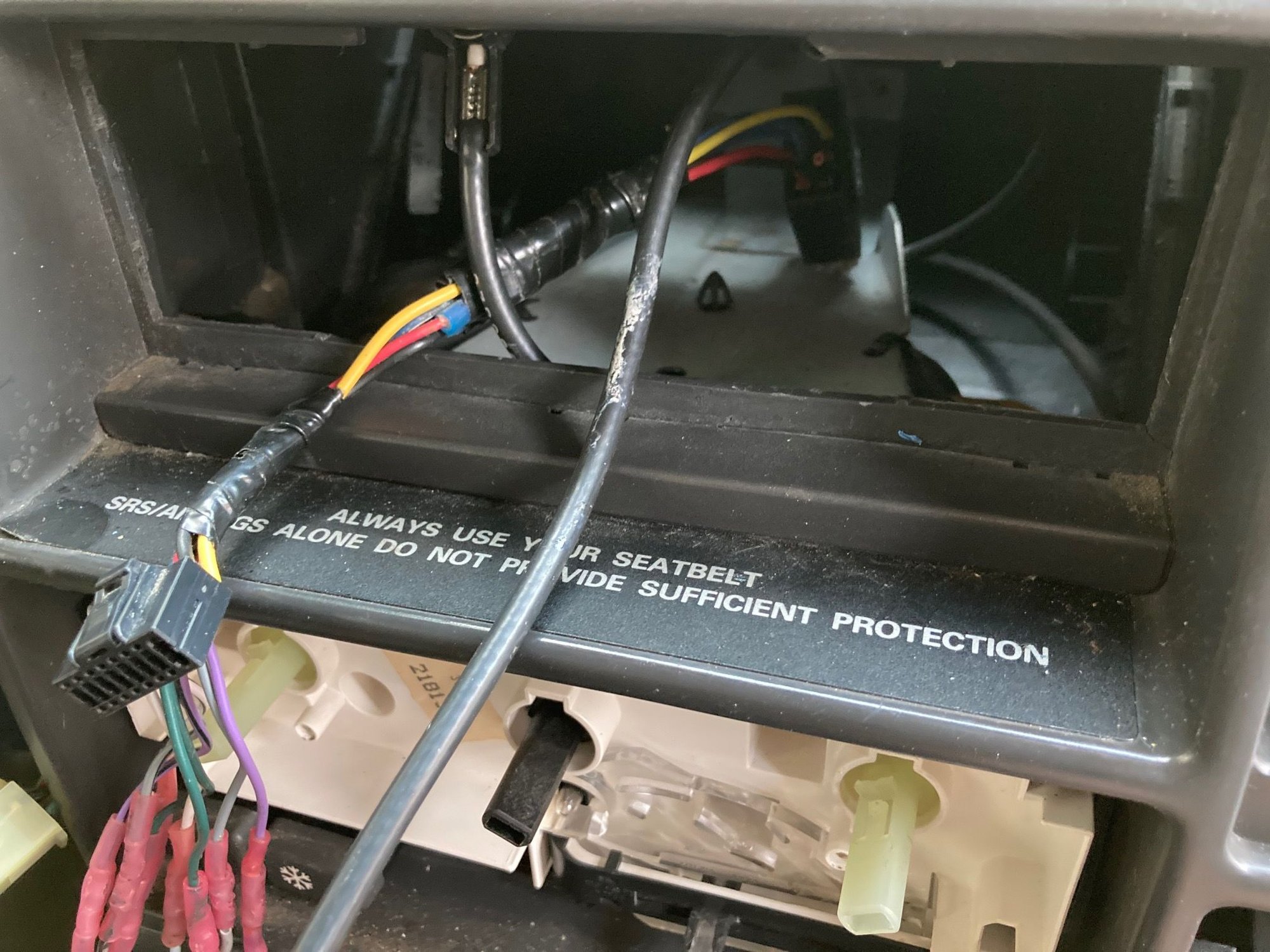

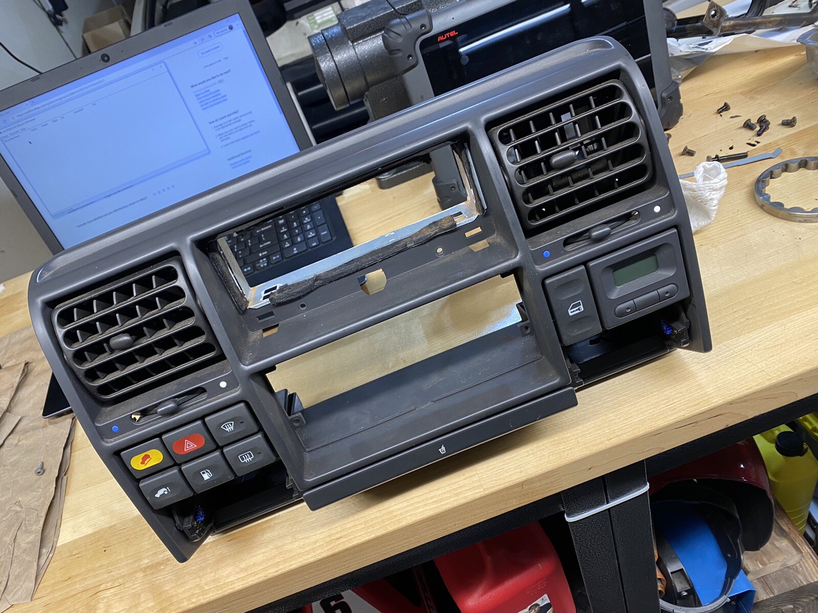

Tips on removing the screw cover below the radio? I've wiggled plastic pry bars on all edges and I'm not getting anywhere?
Should I pry up? out? Which way? Workshop manual is a little vague on some of these steps
Got everything else out on my way to cleaning climate buttons/switch and amp bypass.
Thanks in advance!

Step 13 - Remove panel retaining screw cover.
That piece covers the screws. The attached images show the panel screw cover and the screw holes underneath.
I've been there many, many times.

Yep, Jvarnadoe is right, there's a plastic piece covering the screws. Just push it down and out to remove. Don't be like me and just yank the console out in frustration, having to glue things back together later!

Thanks @jvarnadoe I think one of the PO's glued it. the two bottom tabs snapped off pretty cleanly. It still fits nice and snug so I could care less!
