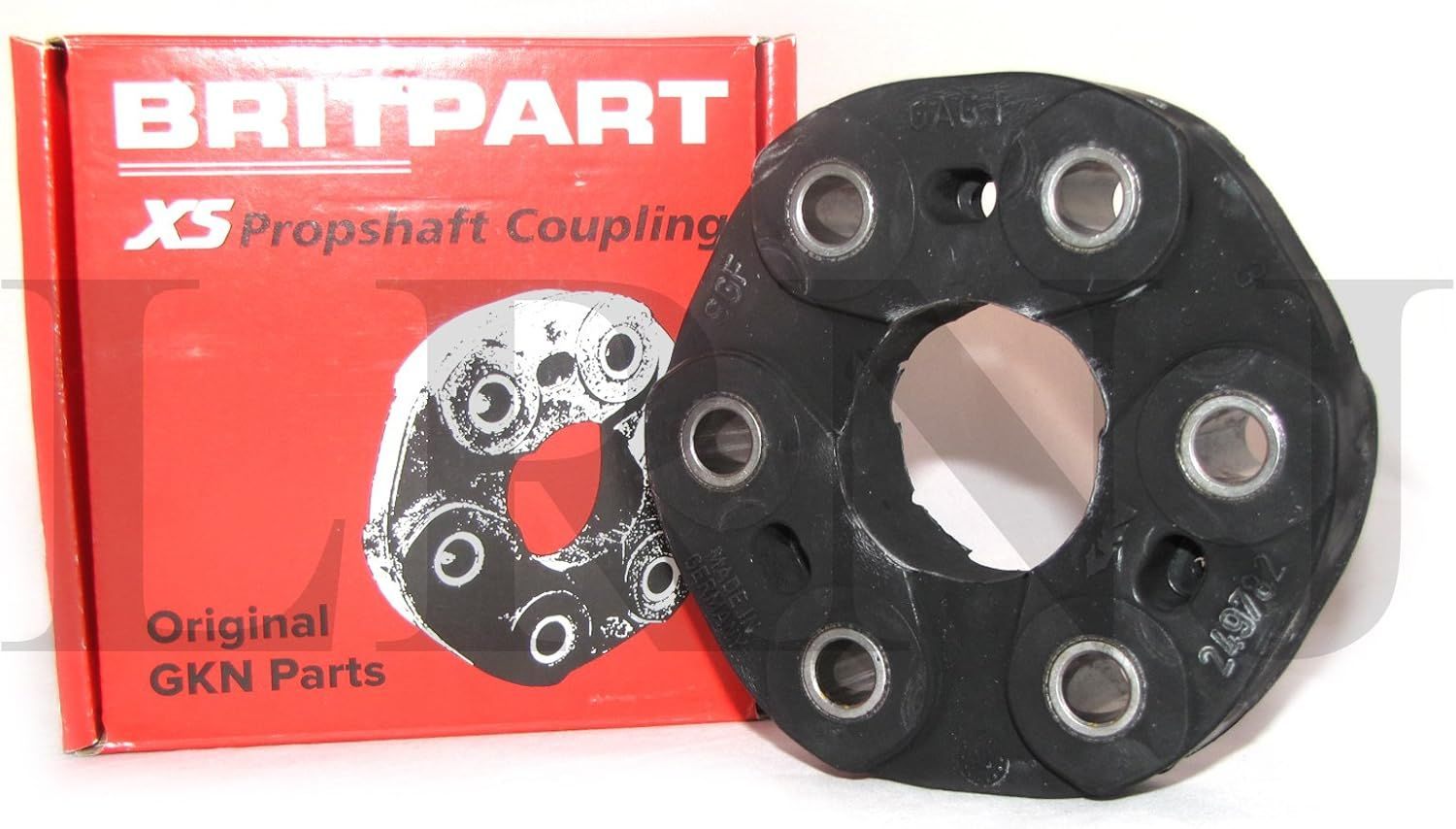

Forgot to mention the BritPart part number ends with G. Usually that means Genuine Land Rover part, and it was advertised as OEM. Does BritPart make parts for Land Rover? The box was not a Land Rover box. I am a bit confused. Did I get the real McCoy or not?
Old Oct 31, 2024 | 11:17 PM
jvarnadoe's Avatar
Joined: Dec 2014
Posts: 232
Likes: 81
From: Erie, CO
I think the lines are blurring in regards to LR parts manufacturers these days. I ordered a Hardy Spicer rotoflex from L8 recently that also had a G after the part number. The part arrived in a Britpart XS branded box that stated original GKN parts.
