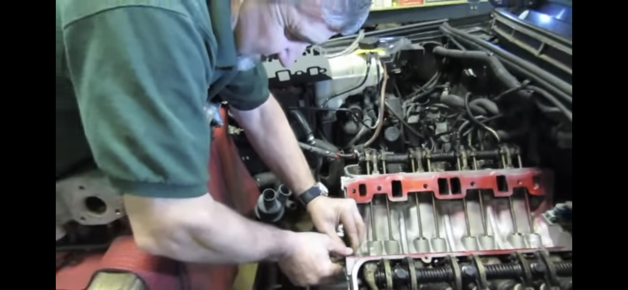

The AB video says to remove rocker arms by loosening the bolts incrementally. When I have the arms off, should I blast them with brake cleaner then WD40 or penetrating oil? How would you clean the rest of the valve area without getting anything making its way further down? How about the valley pan area and all the ports? I want to clean the lifters - are they easy to disassemble and reassemble? I’ll keep the lifters and pushrods organized. I saw an ultrasonic parts cleaner with degreaser doing a good job, so I might try that.

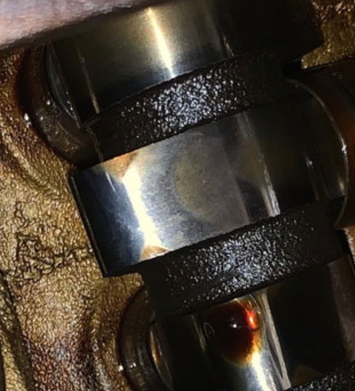

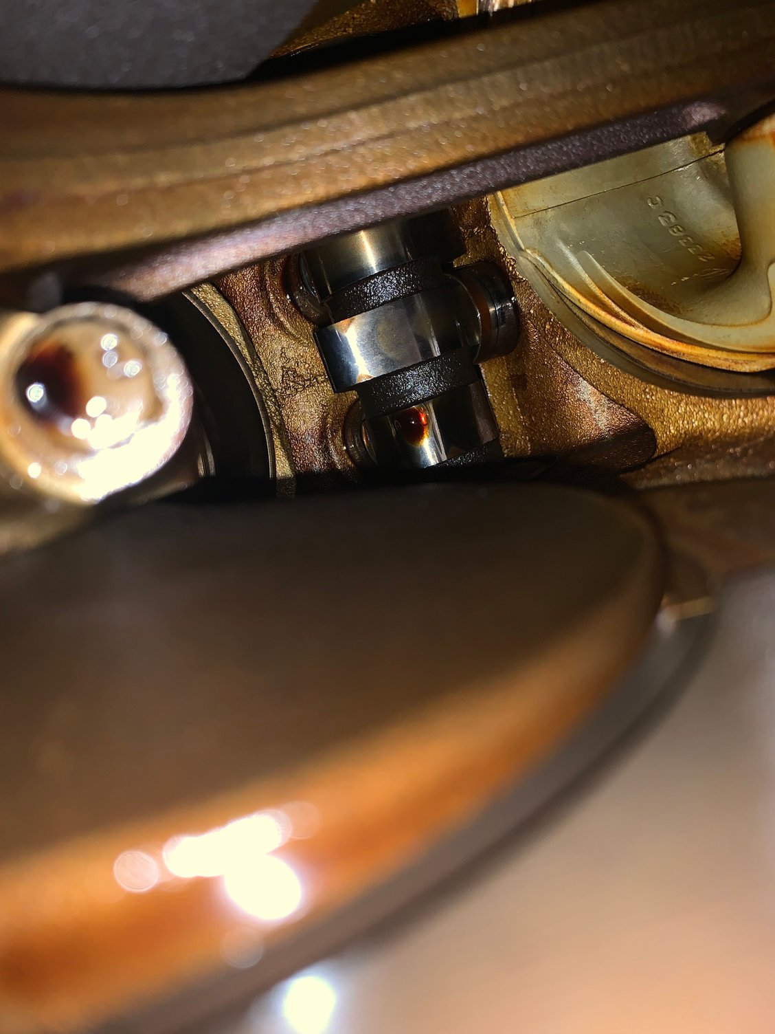

Looking at the document on v8engines.com, I think this cam shows the discoloration that’s mentioned… I wasn’t sure how to replace it, but the front cover and everything is back on now, so it’s probably too late for that… I’m a bit hesitant to disassemble the rocker arms, but if it’s more realistic for me to remove the rocker arms as an assembly to remove the lifters and rods, I could give everything a bit of a cleaning that way, but I don’t know exactly how and if it’s worthwhile. I thought I could try disassembling the lifters and seeing if that’s just extremely tedious or if I could put them in an ultrasonic parts cleaner with a degreaser fully assembly and that would be good enough for now, I’d just do that - also soak them in oil before reinstalling, or use assembly lube when putting them back.

That's a super clean looking engine. Unless you're slugged up to the point of creating oiling problems, there is no benefit to cleaning your engine internals. More risk of harm knocking debris (or worse, dropped parts) down into the engine to cycle thru than benefit from having cleaned those parts.
Leave it all together, close it up, and just keep driving.
Edit: oh, and that cam lobe looks in good shape. All you're seeing there is oil staining. If a lobe is starting to wipe it will lose its somewhat polished finish and often you'll start to see pitting.

I like getting all sorts of opinions, but I guess it won’t be that bad to just replace the gaskets/seals and run it again. I wanted to clean things since I found a lot of sludge in the sump, but it sounds like that’s too much trouble unless you hoist the engine out. Is it worthwhile for me to remove the rocker arms with the heads to have them hot tanked then straightened at a machine shop (I found one with a tank, not sure if they prepare heads) and I’d continue with the head gaskets? I was shown low pressure in a compression test years ago (one of the cylinders on the driver side, possibly 5 which is the one that shows the misfire).
I couldn’t tell of this was pitting on the cam lobes or not since I didn’t really check it before closing it up, just had some pictures to look at after. Either way it’s staying for now since the front cover is on and that was enough of a hassle - not so bad after it was all done, but the first time with any of this work is different. I don’t want to do it again on this engine anytime soon though.
