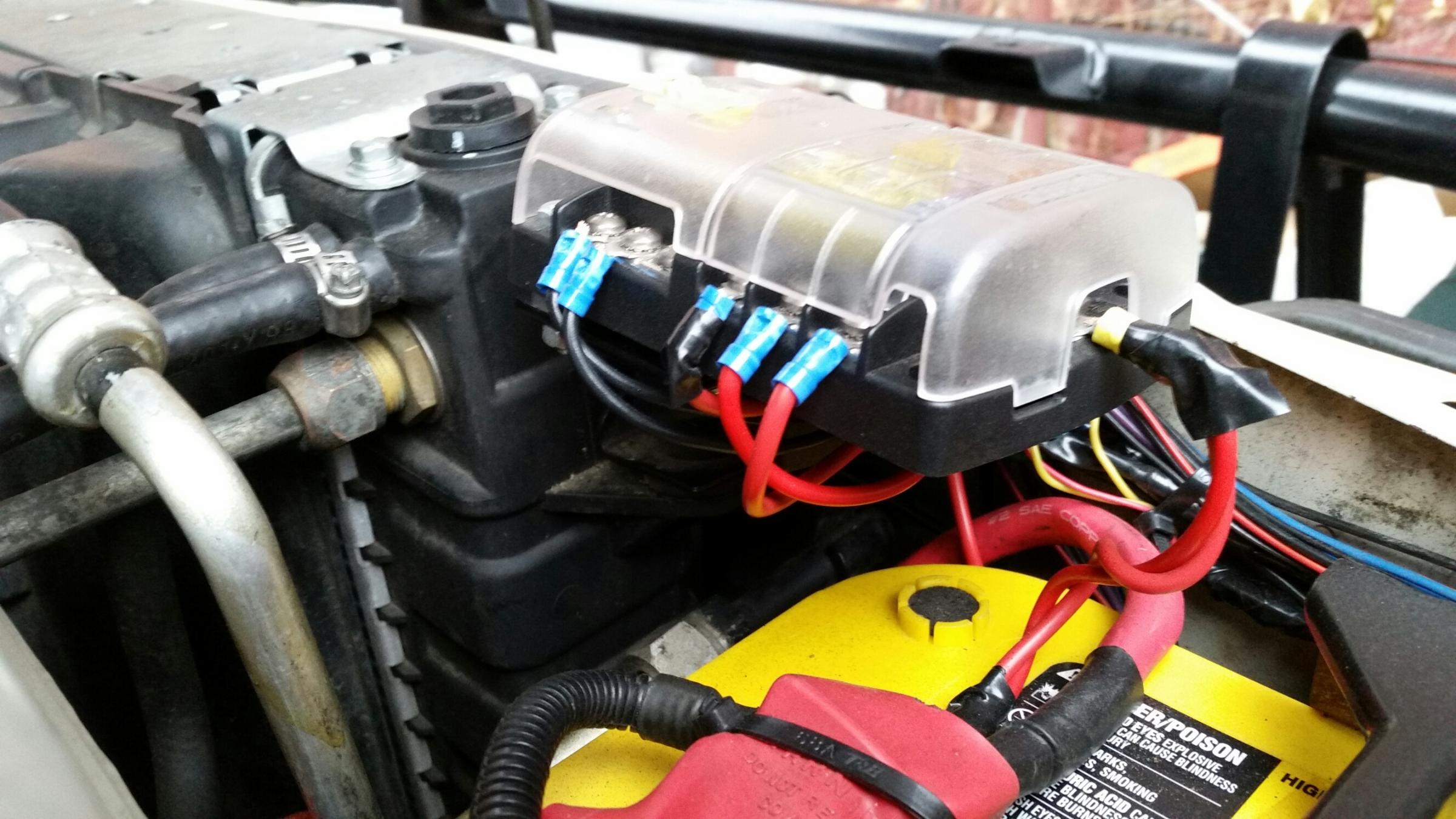

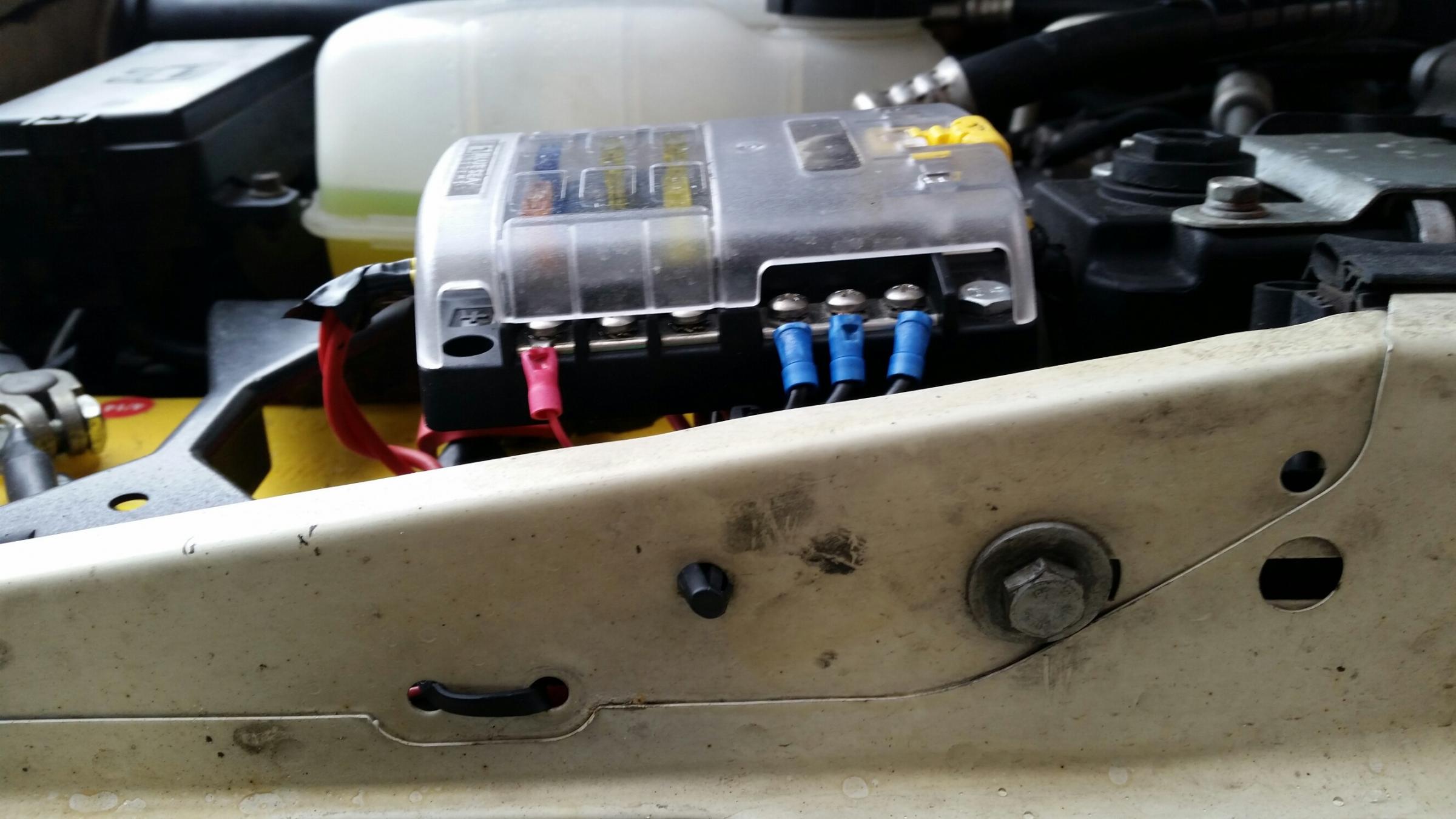

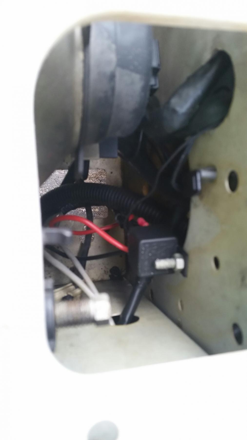

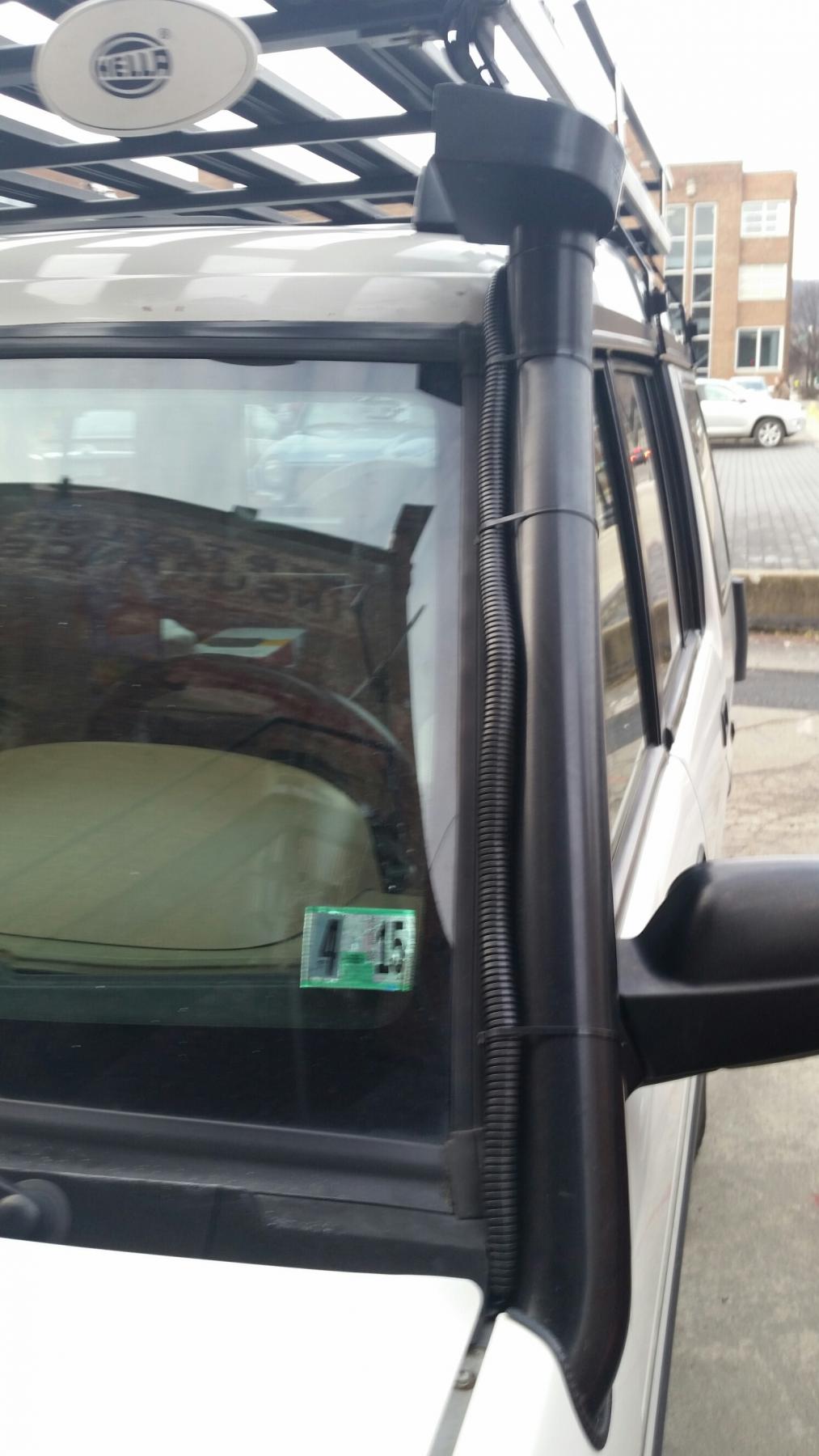

Hey Tom, Here are the pictures of the wiring install to the roof rack, and aux fuse box & relay location. There are (2) duplicate relays next to the driver's side headlight.

Sorry for the bad photography on my part! The fuse box is not mounted to the battery. They used an existing hole in the radiator support to mount the fuse box with a piece of angled metal & the wires across the radiator support to the snorkel. Ended up being a really clean install. Perhaps these pictures will be better.
