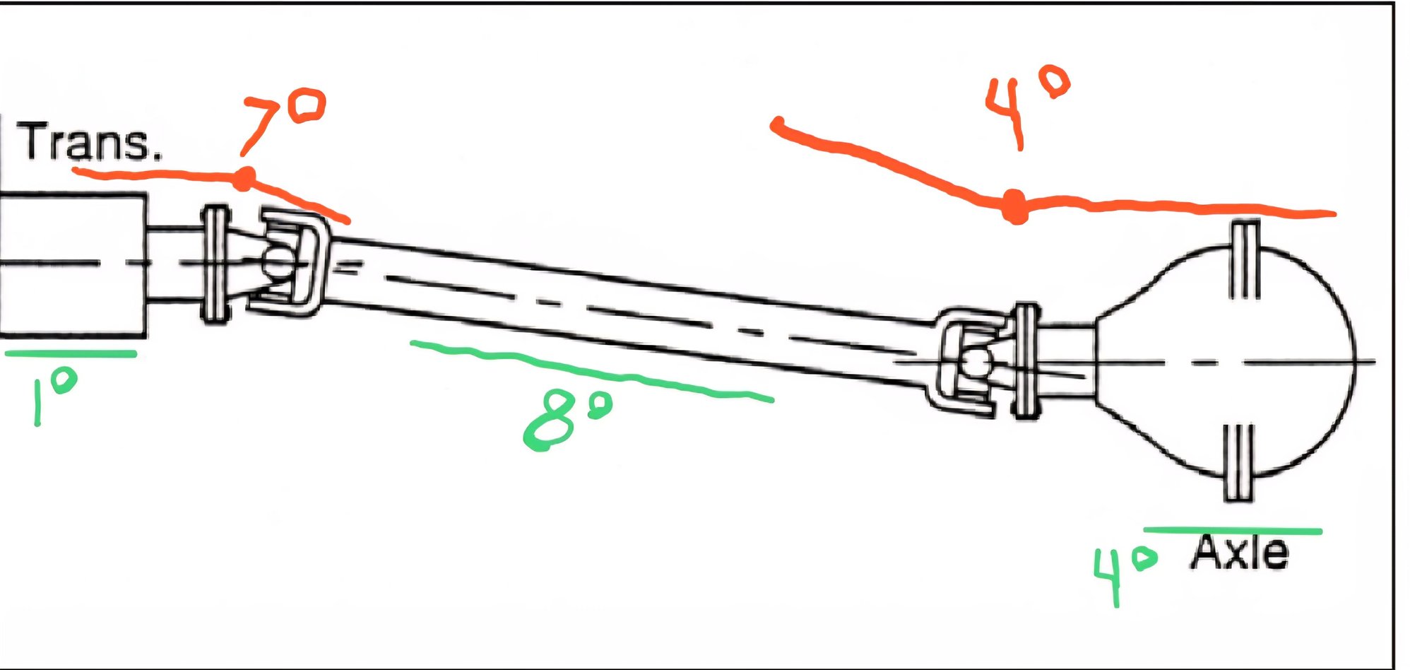

I was planning on ditching the old roto flex. But I'm afraid that since the old one sheared a bolt and wollowed out the driveshaft bushing after 3000 miles I don't want to mask a bigger problem. With the car sitting in the garage the axle is tilted 4° from level. The rear prop shaft is at 8°. While the transfer case and the frame of the car sit almost level at 1°. So the difference in angle is between the transfer case and prop shaft is 7°. And 4° between the axle and prop shaft. Is that normal for a non lifted disco? Would that angle cause the issues that I'm seeing?

I haven't lifted the vehicle but i did replace all of the suspension bushings as well as the track rod and drag link. The previous owner replaced the shocks. And I recently had the transfer case and driveshafts out to get resealed and have the roto flex replaced. I didn't know better at the time and took all of the bushings out at once. After doing this the disco got a pretty bad death wobble after hitting a bump at highway speed. An alignment and tires took care of the problem. However it came out of alignment again soon after. so I'm not sure if everything needed time to settle or if I've messed something up. Firestone also didn't bother to straighten out the wheel and said they got it "as close as we could". So I'm not sure what happened there. I'm also curious to see if its still in alignment after driving with the vehicle shaking for so long.

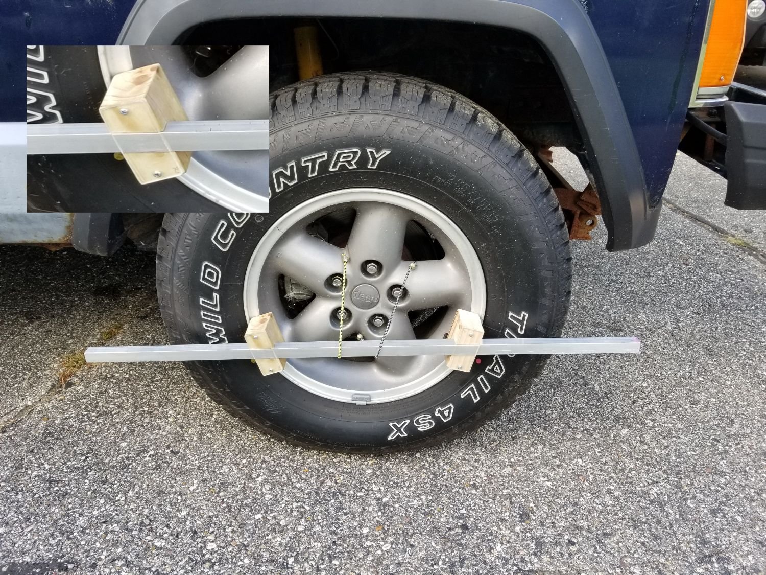

I've been setting my own vehicle's tow for years. Got tired of paying shops good money and not getting the steering wheel right either. Make two jigs from aluminum home-depot square-tube, and some blocks, which are straight & 'true'. Affix to wheel. Lay a tape measure front and back. Set toe about 1/16" (in) on the front. My jig is simple but it works on my fleet, for the little I need them. You don't need anti-friction plates...just make tow adjustments and rock the vehicle forward/back a foot to equalize the forces/wheels. Test drive and re-adjust as necessary. You'll be finished in the time it would have taken you to drive your Disco & drop off at the alignment shop. All my vehicles, the steering wheel is 100% "on the money" going down the road.

That is awesome that you do your own alignment! Sorry, my post was written out of order. The death wobble is fixed. Although when I hit a bump it does act like it might start again for half a second. Ive replaced it with a four bolt flange now. So the vibration is also gone. I'm still worried that I may have done something wrong with the driveshaft angle being that steep. I'll check out everything you mentioned as well. As I haven't looked at several things you mentioned.
